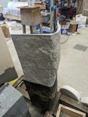

It's a pretty wild project. Who can hope to understand how an artist's mind works?? The subject is this tall skinny boulder.

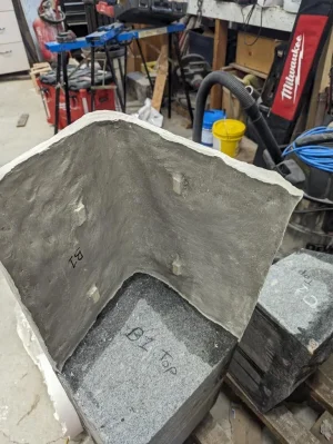

He cut it into 5 rows then cut each row into quarters. So that's 20 pieces. Half of them are to be removed and replaced with cast aluminum copies, in a sort of checkerboard pattern. And with a little space between each block.

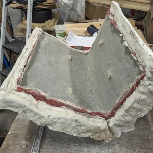

He made rubber molds of just the uncut faces of each block, backed with plaster mother molds. Then he cast a thin (1cm to maybe 1", it's hard to be more precise when smearing plaster around) burlap-reinforced plaster copy of each of those uncut faces.
With wooden pull-screw points embedded into the back side.

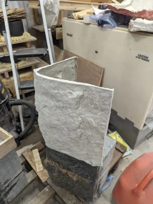

This particular pattern as shown would absolutely not pull clean from a sand mold because of the undercut 2/3 of the way to the right side of the following pic.
It will have to be band sawed in two along the central ridge, then David will have to weld the two resulting castings together and chase the seam. Many but not all of the patterns have had to be cut like that; obviously the less welding and chasing David has to do, the better, but an undercut is an undercut.

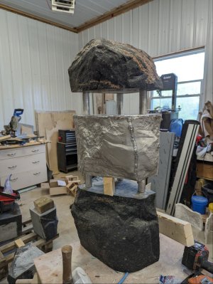

Here is an idea of what it's going to look like, but obviously this is only 3/5 of 1/4 of the whole sculpture. The welding and chasing isn't complete and the spacers will be shorter in the end.
