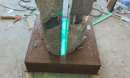

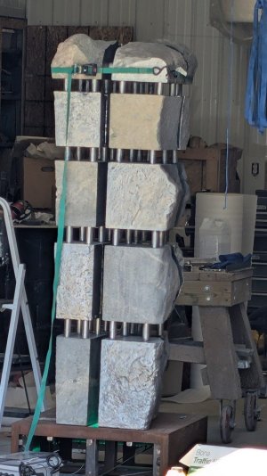

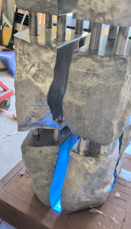

Pic of the boulder sculpture looking closer to finished, David has been busy. Though the lighting doesn't make it easy to distinguish the metal pieces from the stone...
Here's a profile on the artist, that's me in the background working on an experimental tree bark mold while he was being interviewed: :)

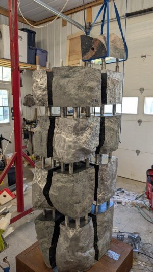

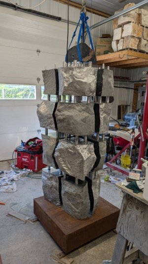

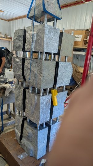

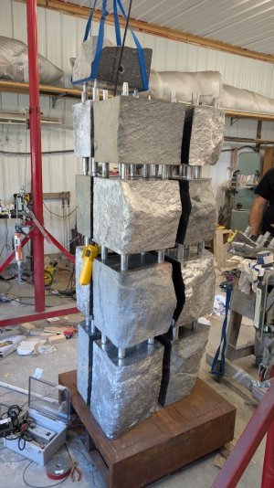

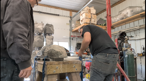

Back at David's place yesterday to wrap up the assembly of his sculpture. Previous pic was dry fit only. It's hard to believe we started casting the parts for this over a year ago!
Here is is from several angles, before the top row cap assembly was glued up and put in place.
PXL_20250526_134607927.MP_copy_567x1008.jpgPXL_20250526_134517639.MP_copy_567x1008.jpgPXL_20250526_134501340.MP_copy_567x1008.jpgPXL_20250526_134433219.MP_copy_567x1008.jpg

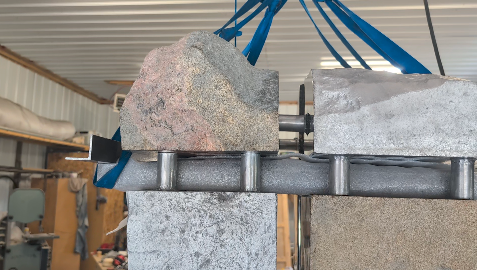

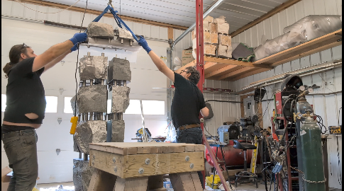

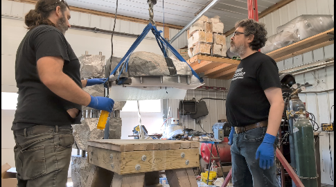

Each stone block is drilled for an epoxied in anchor pin with texture ground into it and a taper on the exposed end. Each metal block had a matching piece of tubing welded to it to accept the tapered pins. The blocks for each of the 4 columns just sit with their pins/sockets engaged in their downstairs neighbour's sockets/pins and are held in place by gravity. The bottom block of each column is bolted to the base (loose for now so they can wobble a bit during assembly) and there are set screws under the base to adjust each column as needed.
The 4 blocks for the top row are also pinned together sideways to lock the columns together. They also have the stone blocks' horizontal pins welded to the metal blocks' horizontal sockets, so once the other end was glued into the stone blocks, all 4 cap pieces were secured together and will prevent each of the 4 columns from moving.
We glued them together on a jig he made for lifting the cap assembly up on to the top of the 4 columns to be lowered into place. Then the jig was unbolted and removed. we had the 4 columns ratchet strapped together to let the glue cure, but we maybe ratcheted it too tight and one of the blocks lifted up a bit. Luckily we noticed and David was able to use that set screw to squeeze the lower blocks upwards to close the gap that had appeared. We moved the ratchet strap to the top row after that. Then we got out the rags and acetone to wipe up the epoxy squeeze-out. He got glue that is meant for this sort of use (anchoring pins in stone I guess?), but with a long cure time to allow time to adjusting the columns and rows.

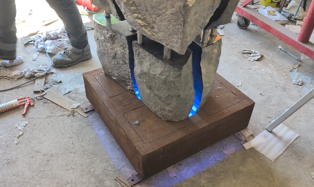

He's having some issues with his LED gear, sometimes the green lights dont turn off when they're supposed to. Waiting on some new components and for the glue to dry, then the cap comes off, the blocks get disassembled, and the whole thing goes to the Oeno gallery in Prince Edward County ON where David will have to reassemble it. ASAP.

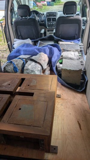

And off it goes to the Oeno gallery in Prince Edward County... With 2 of us and David's gantry crane and genie lift, getting the heavy base, cap assembly, and stone blocks loaded into his van yesterday after work was pretty easy
