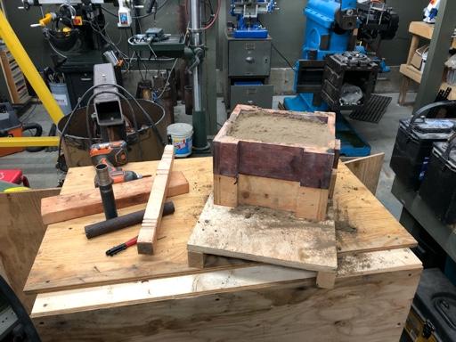

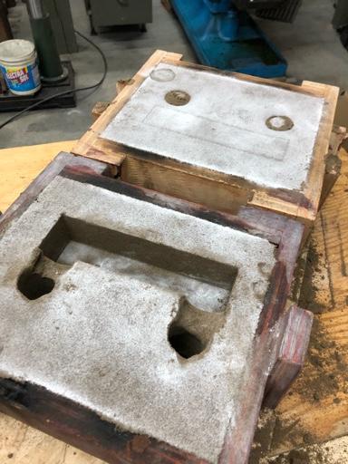

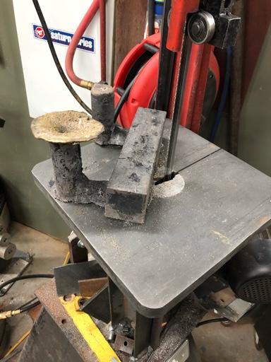

My goal is to make a new ACME nut for a 1"-5 LH. I bought a tap, and decided to cast my own billet. Our old house had solid brass door knobs (love the '90s!), and when we replaced them I kept the bag. 10.5 lbs of them.

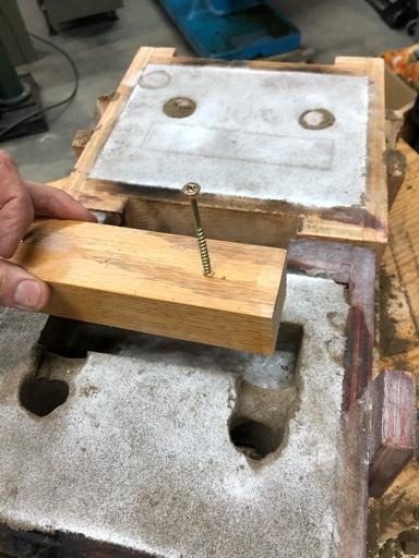

As a mold/form I used a piece of 1 3/4" square oak railing baluster. I used my electric kiln and a sched-40 steel crucible.
Pictures to follow.

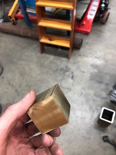

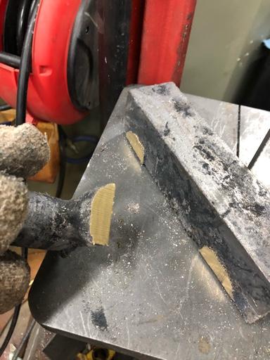

A little charred on the outside, but nice and gold on the inside!
Lessons learned:
  1. The difference between 1750F and 1250F (Aluminum) is noticeable.
  2. Respirator needed for future. Much gasing (Zinc I believe)
  3. Need to make a new cask -- this one started on fire

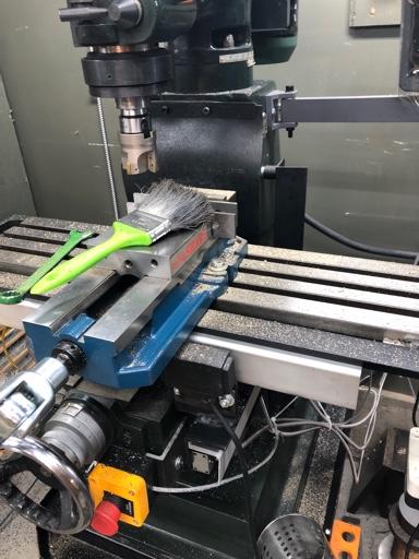

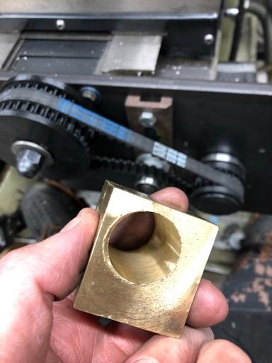

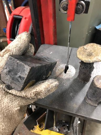

The first blank. Sure dirties up the mill. How one forgets high school shop class.....
Ok, wrecked the first blank...... drilled the hole to the major diameter instead of the minor...... brain fart.....
Well , that was a good lesson in internal vs external dimensions...... embarrassing but I’ll likely not do it again

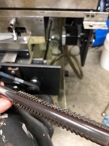

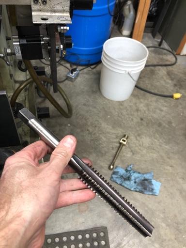

So, pieced off another blank and this time it drilled fine so I tapped it in the lathe (manually) , using the brake to hold the chuck still
The tap I purchased from McMaster Carr is pretty interesting . It is a “through tap” and the literature said to not reverse it as it uses progressive teeth
The first set of teeth cut narrow and deep, the second set widens out the cut
Taps great. A lot of elbow grease required

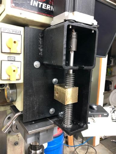

Final product is a 1-5tpi nut for my cnc mill z axis
Just waiting for the final piece to dry (primer) then reassembly.

Kevin> It is a “through tap” and the literature said to not reverse it as it uses progressive teeth
Good job there!
I've heard that about those lead screw type taps. Man, that would be a nail biter if things tighten, the brass starts squeaking & you are not supposed to back up to break the chips because it doesn't work that way. Other than maybe an air blast or cutting fluid, I guess wrench through it & hope things go as designed. I read an article where a guy tried to make his own special tap, several failed attempts (mostly with warpage in heat treat). He got them to tap but were never very crisp. always a it oversize. Eventually he sold a farm animal, bought the obscure tap new, made his nut plus 5 spares for his eventual grandkids, then flipped the tap on Ebay for a bit more than he paid because someone else had the same issue.
