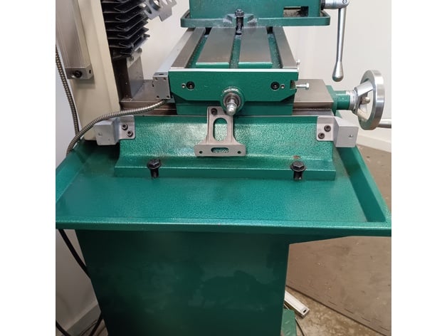

And today I ordered the 4 axis DRO from Aikron. Quill is magnetic, it will fit in place of the capacitive scale that comes on the machine.
It will be a week or two before I have pics of the install. I have taken a lot of guidance from @neer724 thread: https://canadianhobbymetalworkers.com/threads/yet-another-dro-install-king-kc-20vs-2.4866/

Excellent Mods Gerrit!
I recently saw this, if you have a 3d printer might make the DRO install much easier:
Here is another one too
gerritv
Gerrit
thanks,
I saw that first install as well. My printer doesn't have a large enough bed. Plus I prefer aluminum :)
But the second link has some good attributes, esp. the Y axis mounts. I'll print those out and see how it works.

gerritv
Gerrit
All 4 axes are done. Still some cable and swarf management to complete. I made a couple of 3D printed shims and spacers to speed up the install.
X is 520mm AKS scale
Y is 220mm AKM scale
Main Z is 320mm AKM scale
Quill is 120mm magnetic scale, a bit shorter would have been great.
All are 5um.
