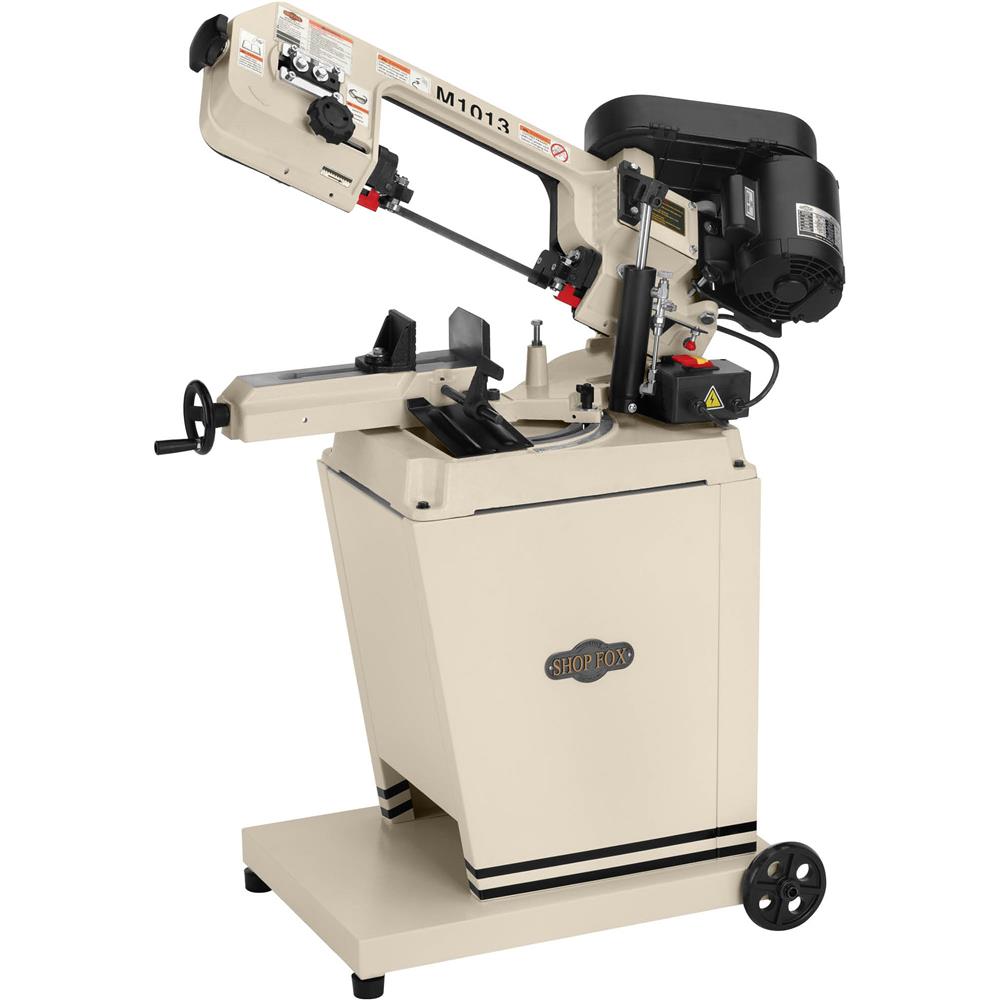

The other day I was sawing some box tubing on the bandsaw and things went quiet, so I assumed it had shrugged off the blade again. Shut it down and inspected it and the blade as on the wheels.
After fiddling about with the pulley I determined the gearbox was failing. I unbolted the hydraulic cylinder and removed the cover plate a thick golden oil poured out everywhere. This was a surprise as I expected the typical Chinese Yak Fat they stick into everything. How they got oil into a vertical gear box needs some pondering. After I cleaned up the mess I used my imagination to see where the gear teeth were on the worm gear. I'm guessing it is bronze
This is a King product KC-129DS and I was surprised to see a service center less than 100 km away in Camrose. If it is a bronze gear and the Yak fat is incompatable, that would explain the faiulure.

This is about 5 yrs old now, and I can only think there may be a design or manufacturing flaw. But the powdered metal like paint in the oil says that the oil is incomparable with bronze. EP zinc fortified grease will allow the zinc to amalgamate with the copper and strip off a tiny film of metal until the gear or bushing is gone. Some modern oils and EP greases are yellow metal compatible but third world...not so much.

Well, the parts gang called today. They are 3 month back ordered. It will cost $81.45 so I ordered it. I do have many ways to cut steel.
Obviously this is a problem part and they can't keep it around. If I knew a way to hob a worm gear, once I have the new one in my clutches, I would like to make one out of steel.

@Ironman - is the BB, https://www.busybeetools.com/products/metal-bandsaw-5in-with-swivel-csa-cx116.html, the same as the King?
Grizzly also has what looks like the same machine.
One of these outfits might even have stock?
Yes, that's the one. BB may have the parts, I'll have to check with them.
