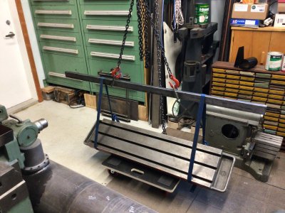

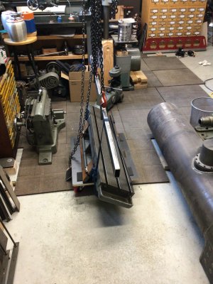

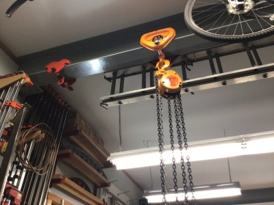

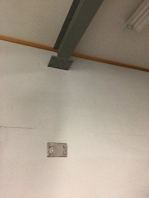

Enjoying a little shop time before work today and thought of the OP. Lifting and flipping this little 300 lb auxiliary mill table (thanks to a member of this site who sold it to me!) would not have been as easy without my shop’s chainfalls. Seems lifts like this are needed frequently in my place even though I’m not commercial.
Yeah, I know tubular webbing isn’t all that cut resistant. I’m just using up old stock of climbing webbing that I don’t trust for anchors anymore and only doing lifts that are three feet off the ground or lower unless better rigged.
