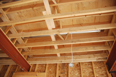

Installed a Princess Auto 440/880lb cable hoist on 12 gauge unistrut track that is 10 feet long with some pre-made trolleys today. It's anchored to the ceiling with sixteen 3" x 3/8" lag bolts into vertical 2x6's that are roughly 16" on center that make up the ceiling (just supporting the ceiling, nothing above, they were put in by the builder so I could hang stuff from the ceiling rather than the metal crap they'd have used for just the drywall), and they span between two huge steel beams, one of which is right inside the bulkhead next to the track (so not a mid-span load). I made plates out of chunks of 3"x6" by 1/4" thick mild steel that are welded to the unistrut itself (ground off the zinc before welding) in a bunch of spots.
Of course, everyone who ever mentions they put these things up in their garages get torn apart by the internet saying it's not engineered and if you try to lift a couple hundred pounds the entire thing is going to fail instantly...so, how is this one going to kill me? I don't ever intend on lifting more than a few hundred pounds with it, I have an engine hoist already if I need to lift my mill or lathe or an actual engine...so this is more just there to act as a third hand when working on whatever.
And yes, already took it for a test run with my welding cart, heaviest thing that isn't my lathe/mill/toolbox in the garage that I can move. I'd guess it weighs probably 200-300lbs given the cart weight, plus two 80cf tanks on it, my welder, a couple 10lb rolls of wire, a small toolbox filled with clamps and more 2lb spools and such, and a big 25' extension cord. It picked it up without any fuss at all, not so much as a creek or noise from above.
Here's a good view of the structure above from when the house was being built (before it all got spray foamed and whatnot):
Looks good, did you use at least grade 5 lag bolts? I have twisted apart some 3/8 lags by hand, like they were cheese (unmarked grade).

They're lags from TSC before they closed, whatever the by the weight stuff is....they torqued down really well.

Hey man, looks great! I put one in my little shop to lift rotary table and anything else unwieldy and heavy to the mill or on table, etc. IIRC, the pre-made 4-wheel trolleys are 600 lb rated so there is your potential limit. I used GRK screws instead of lag bolts as I had them on hand from a pergola build and I believe each screw is 900+ lb tensile/pull rated and I used two per hanging bracket. I am sure you are more than fine...though I didn't see a close-up of the bracket welds 😉

When I look at the load capacity on all the different components in the mix (trolleys, strut, plates, lags, 2x6's, steel beams, etc.) I should in theory be able to lift the full 880lbs the hoist is capable of without anything failing...but not something I'm willing to test.
Also, that I-Beam is structural to the house, it's supporting the floor joists for the room above while keeping the garage clear span. It bridges an 18' span and they used 4 of them across my garage (one being a brick ledge for the second floor exterior cladding though, only 3 are main structural supports) and by code I believe they are required to be fire protected (aka drywalled), and hence will likely never directly be used for anything garage related (ie. I won't put a beam clamp or actual trolley directly on them).
Yeah, there's two trolleys holding it so should in theory double that at 1200lbs, which puts me above the hoist capacity. The lags I have here should be at least 200lbs per inch pull out strength (very conservatively as that's the rating for a 5/16" lag into SPF and I used 3/8"), so I figured 400lbs (discounting drywall and plate thickness from the 3" lag) per lag, and each plate has two, and given two trolleys in the track it should spread the load a bit beyond a single plate.
Welds are good, I'm fairly sure if I did destructive testing the unistrut itself would pull apart before the welds let go lol I had to manage heat a bit to keep it from warping, but everything penetrated quite well as I stitched things around in ~1 inch long welds at various points.

After you have it in place.
Put a LARGE decal on it that states the ‘safe load’ capacity of the weakest link in the hoist.
Factor of Safety = 4 or more.
(Anchor lags, lifting hooks, etc)
Lifting Equipment should be adequately Engineered for the application.
Especially if you are lifting items near human access and work areas.
