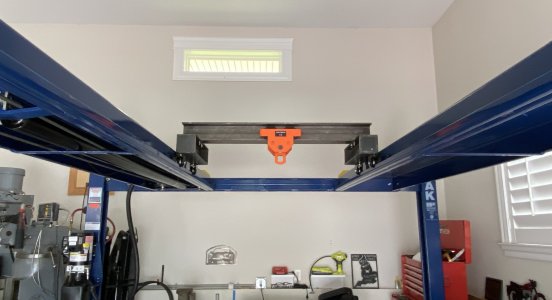

My BendPak 4 post car lift has a rail that runs down the inside of each runway. This is intended to accommodate their rolling hydraulic transmission jack.
I decided to make a small gantry that rolls down the length of the lift, with an I-beam trolley that rolls sideways. Sideways trolley travel distance is a modest 30", but enough to load or unload a cart. I can back my pickup truck under the end, lower the hoist a bit, and pickup whatever I want to unload. Since the BendPak itself provides all the lifting, there is no need for a chain hoist, etc. Only a few lifting straps and hooks are necessary.
The gantry wheels have a stated load capacity of 660 lbs. each, but I probably won't be lifting more than a few hundred lbs. with it. When rolling it with a load, I'll keep the trolley over toward the side with two casters. Four casters would have added to the capacity, which I don't need.
The lift will sit flat on the ground with the trolley in place. Any car with 4" or more undercarriage clearance can pass over it. The gantry lifts off in seconds if a really low slung car has to go up top.

Excellent idea!
Unless the Bendpak is different, most of the bridge jacks on these lifts can lift the entire front or back of the vehicle for wheel service, usually 2 or 3 thousand pounds, not just a transmission.
I would label the max lift on it (something below 660lbs to compensate for the beam, dolly and hoist), just in case you forget in the future what the rollers where rated for.

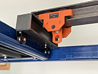

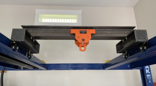

Based on suggestions I received, I made some modifications to my car lift based gantry crane. The top beam now extends all the way over the top of the two side beams. The ends of the side beams are boxed with 3/8" plate, and the casters now have a capacity of 770 lbs. each. Bottom of the cross beam is now 85" above the floor.
I will probably pick up a chain hoist, although it really isn't needed since the car lift itself can do the lifiting. I will probably add some steel stubs that extend from the side beams down into the space behind the rails in case of a caster failure.

I was gonna say that the original design looked weak in the flat area between the beam and the trucks, and could have used some diagonal bracing.
I like this solution a LOT more, as it directs most of the load vertically, rather than relying upon the ability of flat stock to resist bending!
Overbuilding stuff like this is seldom time or money wasted! One never knows when the extra capacity will be needed! Nice!
