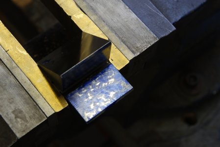

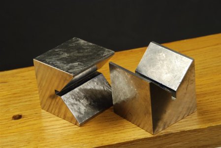

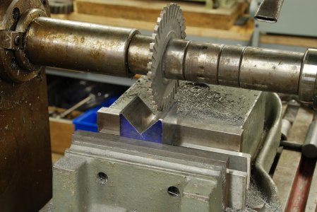

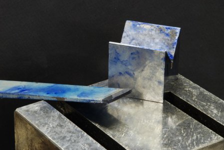

the best V blocks might be the ones you make ..... a few pics to make it interesting. These are by yours truly and are to a tenth in all directions. i wanted them very accurate as they rested on an inverted V way as part of some set up and gauging for a reconditioning project.
You can hit the tolerances you are talking about with simple home shop stuff ....... but you might have to make it to 101.
Are they good to a tenth on a given dimension (eg 2.0000 +/- 0.0001 or on each surface referenced to itself?
Did you make them as one block and then cut it in half, or separately.
They appear to be scraped?
Regardless, awesome work!
thanks, yes scraped, no idea the dimensions as that didn't matter. Made individually. They're matched in size, squareness, 90 degree V, out side surfaces relative to the V, centring of the V etc. Basically used the 90 as a gauge to scrape the inverted V, then with the blocks sitting on the V, the tops and sides of them are within a tenth. Those became the reference surfaces from which to measure (check parallelism of the corresponding way - was it going up or down or left or right relative to the blocks on the V way
