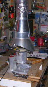

This is my boolit casting setup.
Drier vent stuff. That's an 6" fan.
There is another 4" fan mounted just above the hood that sits over my lead pot (not shown).
Seems to do the trick. Not setting the smoke alarms off now.
Should work good I wouldn't do lead without one! I'm getting the itch to get mine out and melt some aluminum / brass I was out at cross iron today looking at their cast iron cookware they have a nice cast bread pan for a mold.

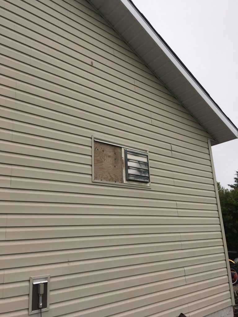

The original owner of my shop did a fair amount of painting and installed an explosion proof fan in the back wall.
It'll pull the main 11' garage door in about 1/2 inch if you don't open a window or raise the door a few inches
It vents out the back
