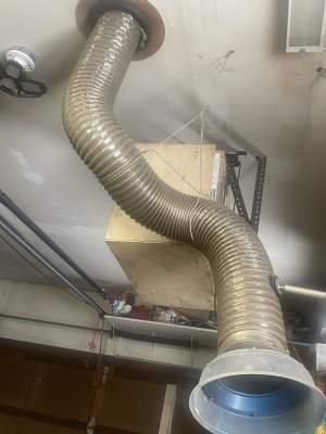

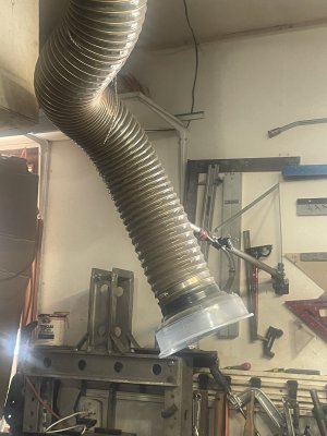

I have a homemade ceiling-mounted fume extractor that works pretty well. On my to-do lists is to improve the adjustability of the control arm for the extractor hose. Kent’s short demo video looks like their extractor gun is very effective and always extracting right where you need it. (pictures - the 400cfm extractor fan is in the attic and exhaust outside, the wood box, hanging on the ceiling, houses a 1200 cfm repurposed furnace fan that sucks through a couple of filters and recirculates air within the garage.
