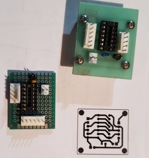

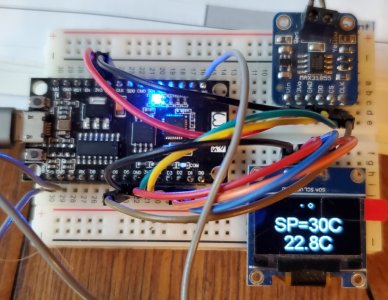

My Kiln uses those pyramid cones to limit the temperature. They heat up, bend and then the switch opens and the kiln shuts off. I'm not entirely sure it would get or stay hot enough to melt aluminum. That's why I was busy building the controller. Not only for heat treating but to take stab, in the winter, at melting Al. If I'm going to use electricity to heat the shop it might as well melt something too.

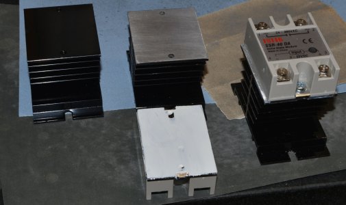

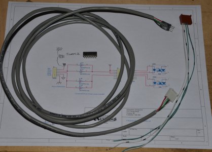

This is the little controller bread boarded with display and there's a knob for the temperature Set Point (SP). I have two SSRs and a little interface circuit for that along with two Type K thermocouples.
