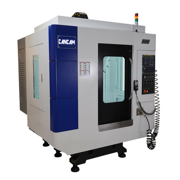

This is a C1-OTAT. I upgraded from the 2.2 kw motor to 5.5 kw. The one shown is the video below is their standard that is mainly sold to schools. My spindle takes ISO-30 toolholders rather than the smaller ones. I also had the Gantry increased to 12 inches from 8 inches. Their standard dust boot in numatic. It is not removable, and so not good for aluminum. I did not opt for the dust boot or the vacuum. The machine is still wired to receive a vacuum system if so, chose later. Also putting their dust boot on would make less Z travel. I insisted on having the spindle bottom just below the LED lights.
Wait time was extreme due to many uncontrolled events. Covid, Shipping Backlog, Rail washout, many orders in front of mine, when they finally received the frame. Total time from order to delivery was about 9 months.
I have been to ASA in Mississauga one time. It was enormous. For convenience's sake, I deal with Essex Metals down here.
See below video for Base model C1-OTAT

Thank you for sharing that. I had been to Cancam's website before but never seen that model (C1) - I still do not see it on their site except for some videos. It looks like a nice machine - nice balance of size and functionality, and a very clean design. I believe the Taiwanese motion hardware used has a good reputation vs other overseas sources/manufacturers. I believe I read that this was one thing people liked about this company, that it was cost effective given where it was made, but also had a NA presence for quality support and after sales service that can be relied upon. Does it ship assembled, or is just the frame made overseas and the USA or Canada based facilities put all the components together and take care of final assembly?
The electrical cabinet looks well organized and neatly put together. I noticed 3 servo drives in the video. Does this CNC have the X axis gantry connected below the table, and a single servo/ball screw provides the Y axis motion?

The gantry is tied in below the table and is controlled by one 25 mm ball screw as you said. Their website is dated and does not reflect their current products. Their main product now are the "C" series routers. They are also in early stages of building a VMC.
