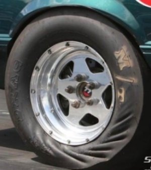

Just a FYI, racing slicks are often run without tubes. Without tubes they leak down in days. Hot tip rub Dawn soap all over the inside of the tires. They will still leak down, but more like 6-8 weeks. Not sure about other soap brands but instructions were clear need to use Dawn, it fills the microscope pores in the rubber. I tried it and it does work.
Why no tubes? If the slick is not screwed to the rim the slick will rotate on the rim and pull the tube with it. Some folks don't want to drill holes for the screws in their brand new super expensive light weight rims.
