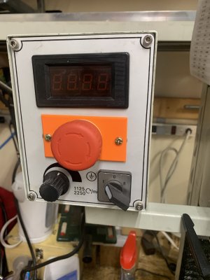

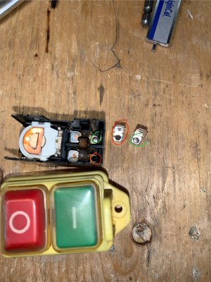

My CX-600 busy bee manual mill won't power on and stay on. The contactor does not sound like it is closing. It will sort of spurt on/off if you push the button hard. I took the switch apart and found dirty contacts. I did some light cleaning and reassembled. No dice. I next checked the relay coil and it measured infinite resistance pole to pole so I guess it's broken wire inside somewhere. This seems just like when motors quit - the coil shorts or breaks and you need a new motor. So why exactly does this happen? I really would like to be able to fix things, fundamentally, instead of replacing parts. 99% of this switch is fine... If I was crazy I could unwind the coil to find breaks and splice it?
BB has these contactor switches on their web site so I'll order on from there or aliexpress. I could just rig up a double pole switch instead...I guess that's a bad idea safety wise.

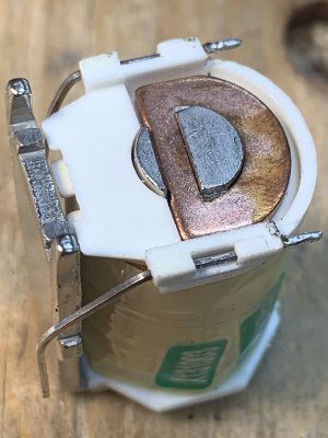

With unlimited time, I'm sure it would be possible to repair the coil. You would likely need to wind it with new wire...which would probably cost more than a replacement switch! I think any little kink in the wire is a potential new failure point so it is not really DIY-friendly.
For a replacement, the main safety feature is that if the power goes out while you're using the machine, a magnetic switch will not restart it by itself when power is restored. Being a machine tool, that's a good feature.
BTW, is the mill 120V or 240V? If 120V, you only need to switch the hot leg; ie single pole. With 240V, some people still only switch one leg. I think that is crazy and dangerous.
my hypothesis why this happened - the contactor was sputtering some in the months leading up to the failure. Occasionally the mill would not turn on - I think the dirt on the contacts was not helping. The sputtering and machine vibration may have further damaged a weak spot in the coil. Ok that seems reasonable to me...how would one prevent this? higher quality coils? Sputtering prevention? Mercury switches instead of sparking contacts? Solid state parts instead of relays? Five why analysis....

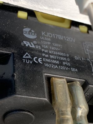

@trlvn Craig it is a 120V mill, just a little guy 3/4HP. But it does have two pole switch - I'll have to look at what the other pole is doing more closely. I think it's a safety circuit which also goes through the chip guard window switch. Like everyone I took that thing off so a single pole switch would probably work.
This contactor has seen intermittent use over a decade. Is this a typical life span for this sort of device?
ok I noticed something here - the switch name plate, below, says 1/2HP but the mill is 3/4HP. ... is that a red flag? undersized?
Looking up the part number, I found a link to a datasheet through DigiKey:
It says these things are rated for rated for 10,000 electrical cycles, which isn't all that many. Old school motor starters (Allen Bradley, Westinghouse, Cutler Hammer, etc, etc) would last far longer and in much more harsh conditions. OTOH, to purchase one of those new would cost a significant fraction of the total for your mill!! IOW, a consumer-priced mill isn't going to include industrial-quality components.
Your contactor seems to be rated for 16 amps which, to me, is more deterministic than 'HP'. Also, the full load should not be going through the coil. The coil only draws enough current to pull the contactor closed. The load current flows through the now-closed contacts. AIUI.
Basically I'd say that your magnetic contactor lasted about the minimum one could reasonably expect. The manufacturer is totally happy since it outlasted the warranty! 😉
