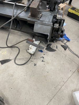

I was continuing to unpack / organize from my move to Saskatchewan this summer . All the equipment was placed on pallets , event the lathes (each end on a pallet)
I was removing the pallets today, and was taking them out from underneath my 1903 Van Wyck lathe. I got one end out, moved the gantry to the head stick end, lifted it up about an inch off the pallet , removed the second palllet, and was in the process of lowering it…… and then it rolled.
I’m still not sure what happened. It was sitting on the back legs…… raised at the head stick about 4”. The front leg casting is in about 15 pieces , not sure if it dropped and shattered or what…… but the positive here is that I didn’t get hurt. The negative is that this lathes was nearly flawless for being 120 years old
Here are some pics
The shop stool took one for the team.

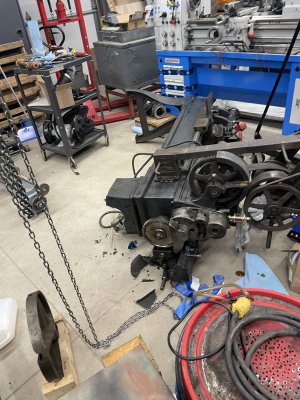

I’ve removed the legs and have the bed on 6x6 blocks for now. Broke 4 of the handles (arghhhhhg!) but the lead screw and qcgb look ok
Be safe everyone, this scared the shit out of me. 99% sure this is operator error. Very sad day. I’ve had this for 12 years and it almost survived a 1200km journey

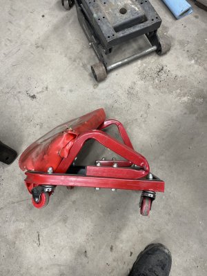

I have a similar casting in my shop with the matching legs. It has some cracks too, but can be repaired. Do you have all the pieces? If not maybe what I have can be of use to you. I was just going to make a grinder stand.

Observations : it happened very quickly . It made a hell of a bang. It did not touch any other machine which is incredible.

Cast iron snaps really easily in comparison to so many other things... I broke a casting once with pressure I thought would barely stress it. It has nowhere near the tensile strength of steel

Try not to let this bum you out too bad, it's a great opportunity to improve your brazing skills and perhaps burn in a little "muggy" rod with the stick welder. Fixing it back up is just part of its story. Most if not all of my old machines have something of a story "rebuilt" into them. When I get a chance after I get back home again I will try and remember to get some pictures of some interesting repairs on the tool and cutter grinder that I picked up last summer, I believe it went over as well, but long ago.

Cast iron is very brittle. I've used a hammer to break castings into pieces to make them the right size for the crucible. As the lathe was lowered a tiny bump on the edge of the leg to cause twisting torque and snap.

Sorry to hear, glad its only broken metal. Where were you rigged from? Those sorts can have a very high centre of gravity, but I guess that doesn't help now. A real bummer :(

In hindsight I rigged it way too low …… I figured I was on solid ground on one end, and only 4” high……. Hard lesson but onward and upward!
