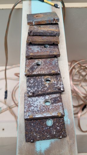

Tips/Techniques Evaporust turning steel black

I've used household cleaning vinegar (slightly higher acidic level) to remove mill scale and rust from material before working it. It's amazing how well it works. But like mentioned by evaporust, rinse a dry afterwards. I got the idea from that Mike fella from Scotland, makes the Big Giant Swords on youtube...

I did an extensive 1 year comparison of various products on my plow blades. I had planned a thread on it soon.
Spoiler - The bottom line is that only two products provided one full year of protection. One was WD-40 Corrosion Inhibitor and the other was Fluid Film. But Fluid Film was MUCH less expensive and therefore it gets the nod.

IMO evaporust chelates far more than carbon... If I was more curious I'd have the surface "defects" on my chuck analyzed.
I dont like sticky parts that come out of it and need washing in water, nor unintended surface changes. I stopped using evaporust after this experience
