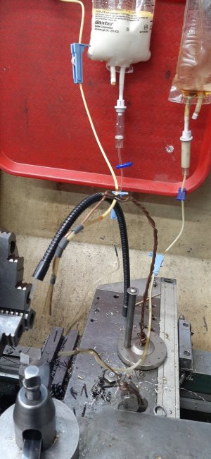

All you need is a medical IV pouch with the hose,the tube pinch valve and the flow valve. Mount the hose on a flexible goose neck or a solid electrical copper wire to a magnet base or tie wrap to the tool post .......
My lathe, mill and bandsaw each have their IV set-up. Examples of all 3 drip systems are in the picture.
You might get coolant all over you if a long curly swarf catches the tube and wraps it around the chuck. It only happen to me once in maybe 15 years.

I love it! great job :D
