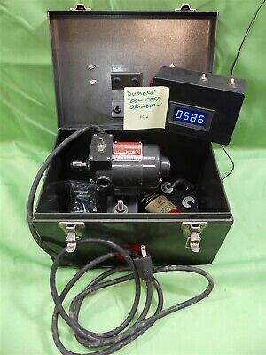

I've wanted a TPG for a while now, and won this guy tonight. Model 8119, catalog number 31-011, 1/5th hp. Is that similar to yours @John Conroy, @RobinHood ?
I found the manual: http://vintagemachinery.org/pubs/detail.aspx?id=19657
It says 8-11 inch swing. I'm hoping it will work ok with my 13" Emco.
It looks very similar to my model 11, maybe yours is newer. Mine doesn't even have a switch, you just unplug to turn it off. The specs on your motor are the same as mine. I found a local source for belts and ordered 3. I'll report on them when they arrive.
