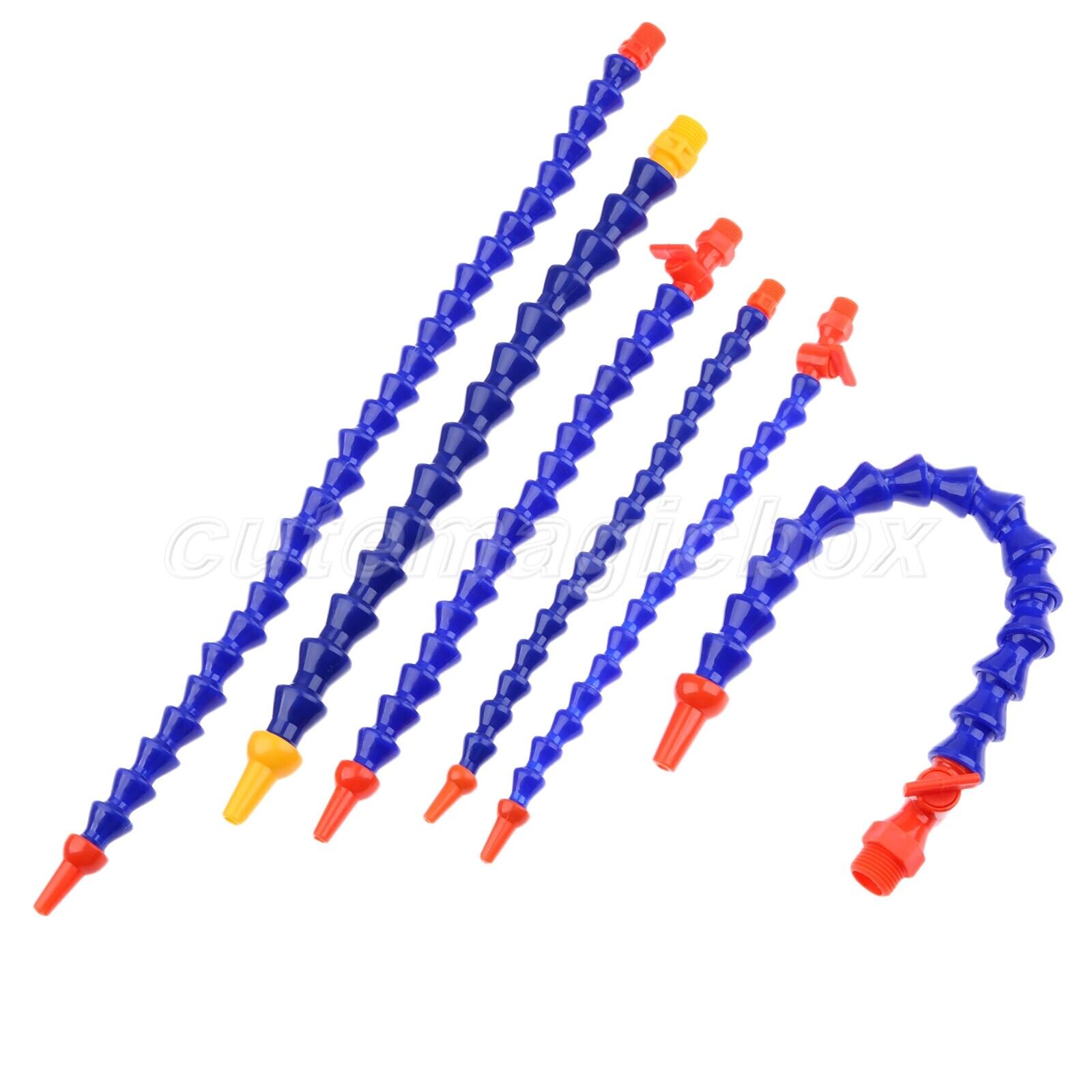

Goofy but successfull idea for cable protection: metal flexible hose from a hand shower. Very floppy, won’t kink, cheap. Only tricky bit is sometimes the connectors need to be futzed around with the to be able to snake the cable through the hose. Hose ends are 1/2” NPT so can be anchored using pipe fittings.
Good tip, I was thinking of using the cheap flexible coolant hose, but this look better.
My tip for you: I have a couple of these flexible coolant hoses on my lathe, but they leak after a while, so I thread 5mm plastic hose through them, which renders the tap at the base useless, and fix a small retic taps at the end. Works a treat no more leaks and the tap is at the tip, where you need it.
