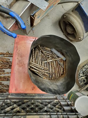

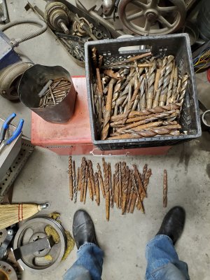

A while back a fella dropped by the shop I was working at and mentioned that he had some drill bits that he wanted to get rid of.....
I haven't gone through them yet, but for $100 I am a pretty happy boy......:cool:
Some of them are pretty rusty, but the majority are serviceable as is.

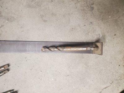

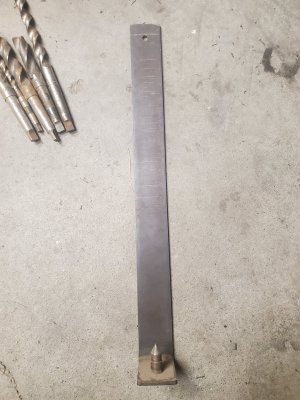

On, I think the only major (to me, anyways) machinist tool buy where the owner of the tools was still alive to talk to, I got this little "scratching post" that he made for checking that the cutting edges were the same length from the tang on the larger bits.
I'm not sure if I would have figured out what it was for if I hadn't been able to talk to him....
So far it looks like they are all metric morse 1 and 2 tapers, but I am still only scratching the surface.....
I like that scratching post idea. I've never seen that before. Handy but only tells one part of the tale. Used in conjunction with a drill gauge would be a great way to re calibrate yourself from time to time. I'm going to stick one on the quick and dirty project list for next time I'm out in the garage wandering aimlessly looking for something to do.

The scratching post isn't only for cats...nice. I would hang onto that metric stuff. Hard to find in a supposedly metric country.. You won't wear them out for sure, but when you need one, they are way better than "getting close" by inch drills.

Yes, you still need a drill gauge, but it is hard to get both lips on the same plane with just a gauge. I just thought this was too slick of an idea not to share with those I like....... As to the rest of ya, well, you're not members here anyway, so screw ya.....:p
