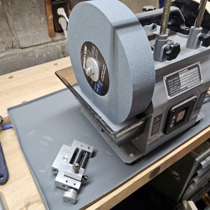

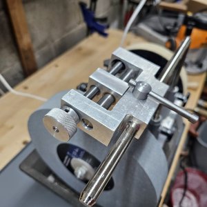

Here's my wheel dresser for example, what a difference concentricity and exposed fresh grit makes. Crudely made to get into production quickly....but more solid I think than Tormeks and works well. Because of clearance between wheel and shaft it definitely benefits from truing before first use
It looks like the thumbscrew is displacing the diamond dressing point along the wheel via a threaded rod? Nice gadget.

Peter, its a Canadian tire wet grinder, Mcgyver'd wheel dresser 🙂 dressing point fixed in a block that traverses the wheel via screw. Frame locked to arm via split cotter.

Must be this one? That's even cheaper than some of the 'Chormek' models I was eyeing. The reviews said Tormek accessories don't fit which, like you say, who cares we can make our own.
Have you upgraded the wheel or have any insight if Tormek wheels can be swapped? Maybe that's where some of the other clones differ.
@Mcgyver and Peter. I have the same grinder branded and sold by Busy Bee. Happy to take measurements or provide any info you guys want.

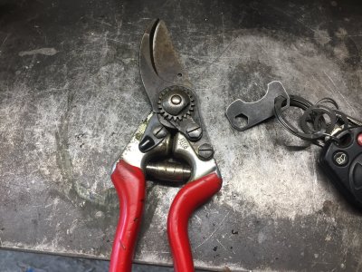

Most scissors have a sharp edge that is straight. Bypass pruners have a curved blade which makes maintaining a constant sharpening angle more challenging than for normal scissors. Suggestions welcomed!View attachment 69121

I've tried every way of sharpening the blade and best two methods both require you dismantle the tool.
If the blade needs sharpening then the grease well probably also needs cleaning and dressing.
When your wife bought the secateurs they would have come with a supplied tool for dismantling, the little steel tab on my key ring. That's all you need.
Clamp the round part of the blade in a vise and use one long stroke of a file to do the whole curve of the blade.
Don't file the flat side of the blade!
If you're lazy like me and have a belt sander then all you do is use your wrist to turn the blade.
Trying to sharpen the blade while it is all assembled can be done in a pinch but you can only sharpen some of the blade and that will have to be corrected when you disassemble.
There is a tiny notch on the blade right down at the base, that's for cutting wire.
The picture you posted is of the most common model #2 but model #8 is a much better design for people with smaller hands and for all day pruning.
My picture is of a pair of #8's
