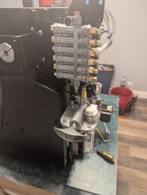

Day 2. Ball screws.
Issues.
1. I installed the oil nipples that can with the ballscrews. Wrong ones. The 4mm ones are in a bag with the oiling system parts.
2. Way covers for the Y axis are a bit fiddly, but they'll go on, just take your time.
3. The backlash system is weird (stacked flat and lock washers). I'm sure a good spring could fulfil the same function.
Otherwise, moving along.
Cheers

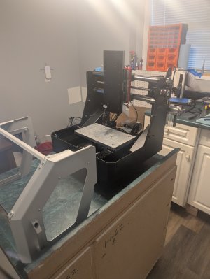

Day 4. Z axis assembly, bed level and square, oil lines
1. All went pretty well. Some places are a little hard to get a shim into but it's doable. I had to add a .002" shim to both sides of the X axis in order to get the Z & Y axis squares.
2. The oil lines are a little tight running up behind the Z axis but the will fit, just don't cut them too short cause it's a B to swap them out. LOL
3. Starting to get a little heavy to move around.
4. The last thing I was working on was the sensors for X and Y. The X one is impossible to mount with the hardware provided M4x25 & nut as I can't get the nut into the tube as there's 2 other screws in the way from the rear X axis rail mounts. Might have to remove them first. We'll see tomorrow. The sensors also need to have the mounting holes drilled out a size or 2, so take it easy. They have their own mounting screws, but cheap ones. I'm also going to glue the X sensor in place as only one screw will fit.
Tomorrow's another day. Cheers

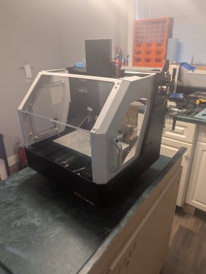

Day 5
Main assembly done, on to the outer shell.
Issues: X-Axis sensor really difficult to install bolted thru the small frame tube.
X-Axis was a little tight at the motor end, but only had to knock it a touch to the left and it runs good now.
You will have to separate the X motor coupler to get that piece in as per the instructions.
Note the added allen key to make each axis easier to move during adjustments. Works great on a cordless screwdriver, which is also a great thing to have.
Mike R has really good assembly and setup info in his post (DMC2 Mini Mill - build and review). Thanks Mike
Onward and upward.
