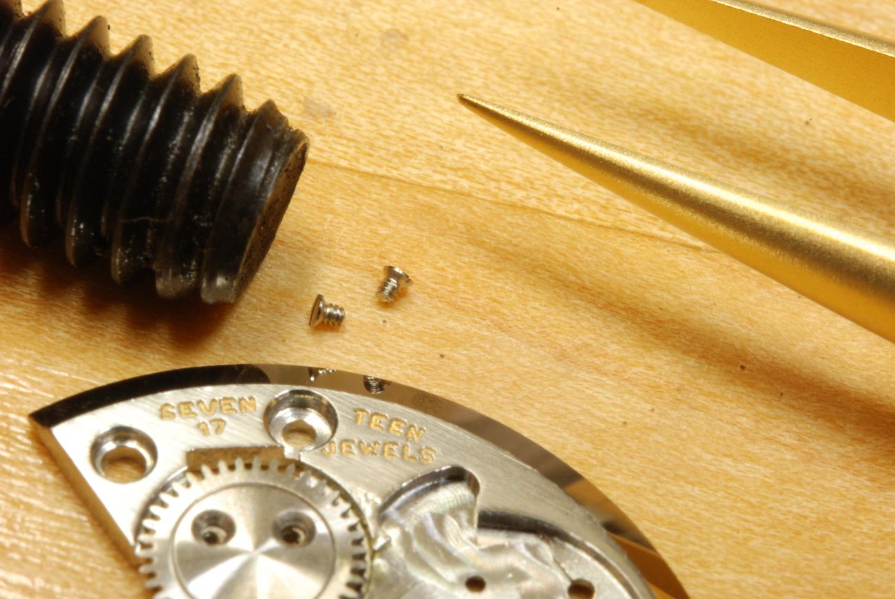

6.5, the trick is to use tweezers. Good dumont watchmakers ones. They become an extension of your hand whereas not so good ones add to the frustration. A great deal of success with small work is deftly handling small parts with tweezers, imo its a skill that take some time to develop (I've a ways to go but watch parts don't go "ping" across the room as often as they once did).
here's a watch screw against a 1/4-20 socket head screw. working with them would be close to impossible without tweezers.
Thanks for the tip Mcgyver, arthritis in the fingers doesn't help working with really small stuff either.
