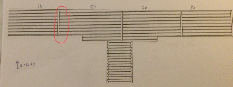

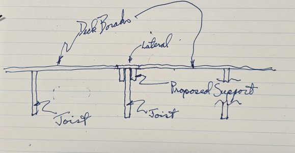

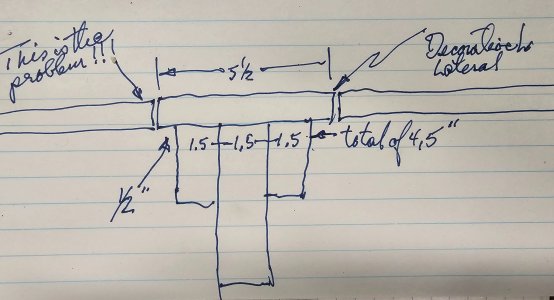

These are your 3 ideas ? Detail 2 is the best, both 1 & 3 add a lot of twisting force to the existing joist, probably ok, but not great. 1 would likely need carriage through bolts to keep that stack together, the other 2 options would be fine with standard .120 hot dipped framing nails
You should also put a membrane on the top of the stack, water will collect on the top and work it's way between, rotting things out over time. They do sell a product specifically for putting on the top of deck joists, I don't recall the name of it
Agree with you, but would say that 2 might not be wide enough.
I'd also add that 3 needs the bolts.
Option 1 sucks as drawn. I wouldn't do that myself no matter how much $ it saved. It is a future problem waiting to happen.
A 4th option is to get rid of the decorative laterals. They compromise the deck structural design too much for the aesthetic value.
An option discussed but not drawn is the narrower laterals with a 3 board joist. I like that one too.

yes 1 sucks, i wouldn't do it either, but it was mentioned thats why i drew it
2 is the same width as 3, they are both 4 ply, there is 2 existing joists drawn, i recall @slow-poke saying he had some double joists, that is what is depicted, it may be hard to see if your looking on a phone. I dont think bolts are required for 3, loaded up with 3 1/4 or 3 1/2 .120 framing nails and you would have a time prying that apart with a burke bar, we can agree to disagree on that. There could also be the option of pl and nails, thats still less expensive than a pile of grk's.
Edit, sorry, your right 2 is 4 and 3 is 5, giving 6" vs 7.5", yes may not be wide enough
im guessing the perpendicular boards are there to deal with the overall length, although staggering the butts would give the same results and hide any length problems, it would still likely require some blocking. But im guessing he wants to reduce the cutting and waste, that trex is hugely expensive.

I would do option 1, but rather than 2 2x4s I’d use a 4x4. In addition to fastening it to the joist, a hanger at each end will provide vertical support and reduce twisting. You only need to support the end of a 12” cantilever so my gut tells me that twisting won’t be a problem.
