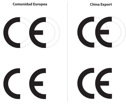

So the China Export mark means exactly nothing as far as safety is concerned. Beyond that the actual European CE mark does not require testing by a certified lab, anyone can display the CE mark based on their internal testing and only if someone complains will the CE authorities request the test results which in many cases does not exist at all or if it does exist is entirely short of the actual standards.

Well, isn’t that sneaky, thanks for pointing that out.
That said I’ve never blindly accepted any marking claims attached to Chinese made product, based on national reputation.
