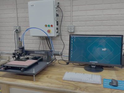

Several posts for the Dahlgren System 300 but nothing found for System 100 a smaller engraving area 8" x 12" with air solenoid Z-axis. Mine was purchased new in May 1989 and is still in operation. Latest project has been to build a motion control cabinet using the Mesa 7i76EU, LinuxCNC, and a custom web based design studio for text and SVG layout. The studio has a simulator and post processes g-code.
I frequently see posts from people who acquire the System 300 table without a control or a system control that no longer functions. What I have developed might be an option for these situations. I am not selling anything. What I have to offer is free to use if interested.
One step closer. System 100 back in place and cabinet mounted. Embarrassing amount of time in this project.
