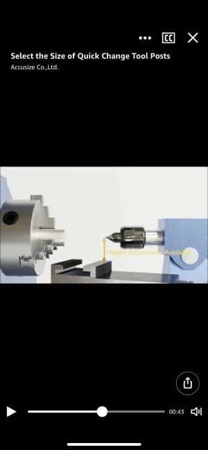

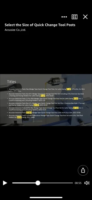

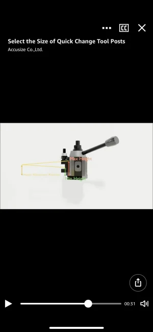

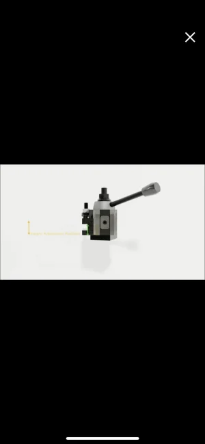

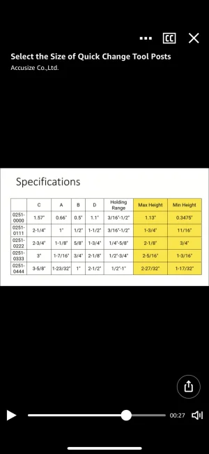

I saved this info from Amazon while shopping for a QCTP for my CX706. The QCTP shipped by Busy Bee has Accusize branding.

The trouble is that none of that shows YOUR measurements. Or if they do, I can't see them. The only measurement we need is the very last one in your attachments - which is the distance between the top of your compound and the centerline of your spindle axis of rotation which is usually also the centerline of your tailstock.
