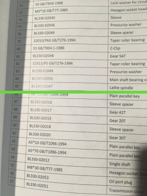

Thanks john, Oh! And i can return both pairs of your safety glasses . im going to make the trip some time im the next week to busy bee to see what they say. And start looking at the parts blow up. The lathe spindle is item 85 on the second image and is green on the first
this appears to show a one piece spindle with the backing plate, mt5 taper, and 1.5" thru hole as one, i will need access to a larger machine to make new holes, one reason i am steering away from an adapter plate is the loss of work space, its not a long bed and i already loose more space than i like with my poor choice of tail stock adapter for my drill chuck, new holes just seem so much cleaner albeit more work

'new holes' .... this is where I'm still confused.
- If you are saying new holes in a new adapter plate, that would be a mill or drill press work because the holes are perpendicular to the plate. You cant do that in a lathe. The plate OD/face/shoulder turning itself is done in-situ in the lathe starting with a semi machined blank. That guarantees that it is 100% concentric with your spindle. You mount the semi-machined blank on the spindle & turn it to whatever the (typically plain back) chuck dimensions requires. Then do the drilling.
- if you are talking about pulling the spindle & drilling new holes on the spindle nose section (yellow hilite)... well that's a different journey. Not only have you permanently altered a lathe that was set up to a specific standard, but you get to re-assemble all those bearings & re-establish the backlash fits etc. (pink shade).
