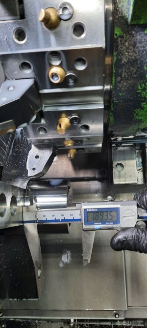

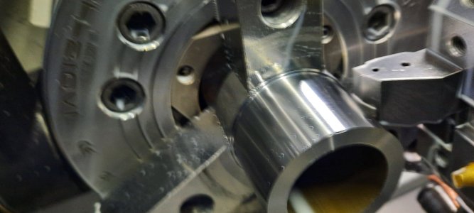

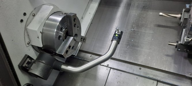

Thought I had my calculations of the step jaw depth correct.
Nope...
Could have been a disaster lol.
Well, time to put a parallel in behind it, then shake off the goose bumps I got from it.
Making a sleeve bushing for a smaller diameter pin

Its a 2 axis CNC Doosan lathe, Fanuc control Puma 2100B. I don't run on a JIT schedule but, I wooed down the feed on this "Just in time"
Wouldn't have got to the full 2" depth before turning for the second op with that set-up lol.
I hear ya on the... Oh $h-t "won't do that again"
The aftershock would have been harder to shake off then the goose bumps had I hit the jaws again !

The above picture was a bad quick measurement on the part stick out. Just trying to do a quick bushing can haunt ya sometimes when not paying close enough attention. The gut told me to double check as usual, when I didn't, the goose bumps made me turn the feed down quick to save the damages that could have happened.

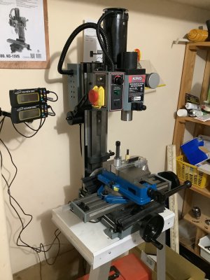

Sorry about your shield damage - Eric.
I was a manual machinist at Ex-Cell-O - 40 years ago.
We specialized in custom boring heads and carbide insert cartridges.
There was a CNC department as well as carbide insert grinding stations.
After a few decades of machinery development & automation projects I am educating myself about the development of machining and operations that I can achieve on my little mini-mill.
If you are down to Kitchener sometime, there are a few CHMW members in the area.
Give me a call (M. 519-320-0384)

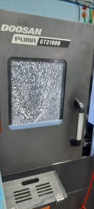

As to shattering your glass, forgot to tighten the chuck? As the hit looks close to the chuck end and no mention of crash was made other than near miss.

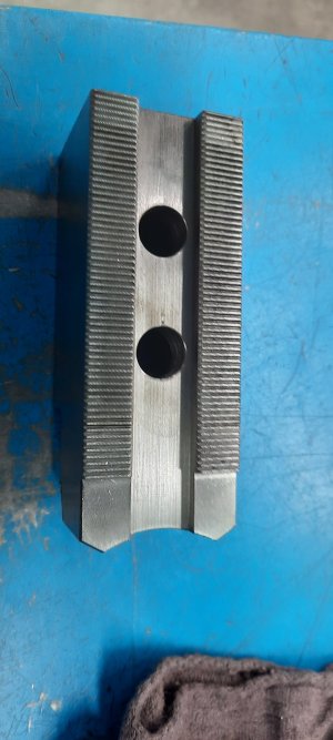

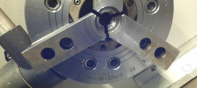

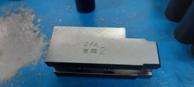

I was never a CNC lathe guy. So this is what I learned just recently . Well a few months back. Tried to figure out how the lathe launched the 8x12 piece of 4140 at me.
Yes, I had to clean my drawers out after that 1 haha.
Too start, let's say...
The lathe jaws are all numbered ( well I think some cheap ones aren't) although I have some that are not. Why ? I dunno....
This is what really happened lol.
The bottom of the lathe jaws serrations are so close together I have a hard time seeing how many serrations I'm either inside or outside that need to be counted.
Yes, I should have used my mag base and indicated afterwards just to be sure it was running true haha.

Wow those are fine serrations, I can imagine that would be difficult to use. I wonder why so fine.
You probably see where I'm going with this now lol..The chuck has numbers on it. 3 jaw- so 1-2-3 is engraved. Would have been good information to know before I riffled a few parts at myself...
Good thing I got that sorted out after a couple mishaps haha.
Because once I machine the jaws for specific diameters and depths, they need to go back in the same location, if not then, yup I need another new window haha.

This was the window several months back. I took the other photo down so I'll through this 1 up instead.
Oh, the sound of the part hitting the window and bouncing inside the lathe till it was in the chip conveyor was like a 6 in the mag 1 in the pipe gun shots going off.
But, it's all good now. Finally figured most things out...
So thats how you can take out your CNC lathe window.

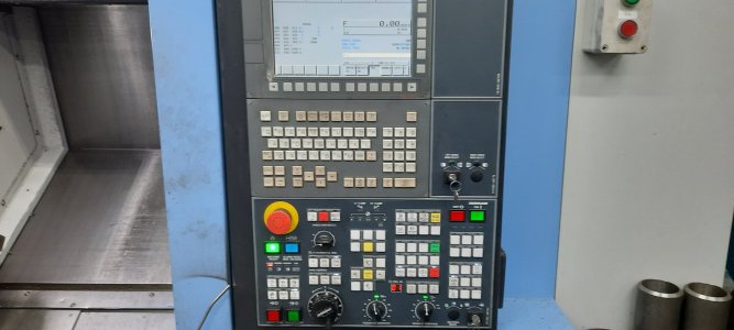

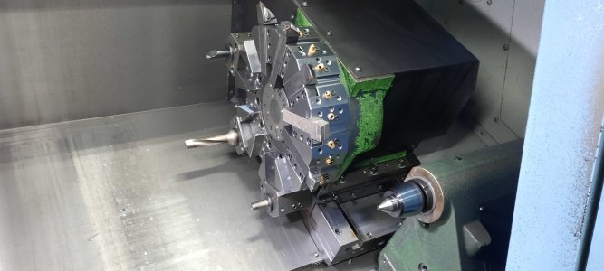

Couple quick pictures of the lathe before I get busy here.
If you notice my live center no longer has a point to it either haha.
But its been replaced... several times lol.

I must say, the window is tough, the hub I was doing didn't come through it, spinning it at 3700rpm. Didn't take long to spit it out that's for sure.
Since, I was up close to that window watching my distance to go I figured I got lucky. I didn't have to shell out another 5k for new dentures.
