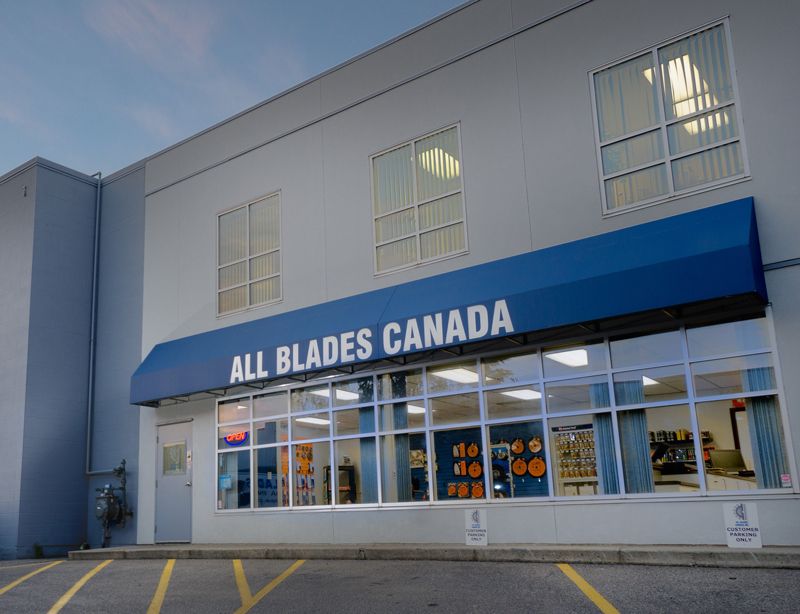

If it's more than one or two, I would choose to have them sharpened, not do it myself.
If in Alberta, ask Allblades how much it costs to sharpen "X" number of "Y"-fluted endmills.
If you're elsewhere in Canada, you may find a local sharpening service.
This seems like a very practical and potentially cost effective solution.
If there is such an outfit out west, it only makes sense that there would by one or two in the east too.
Have you ever used them yourself or this something you ran across and are thinking about? Can you vouch for them?
I have used their service myself from time to time. A friend of mine did more regularly, running a HAAS CNC, and I remember him sticking with them for a while. Back then he had "batch" projects that would use up tooling, then he'd fix or replace things that broke, or sharpen what was dull, to be ready for the next lot.
