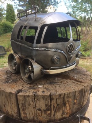

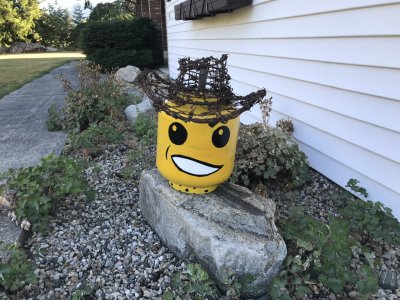

I can think of a couple great uses for that old tank…
You can get new-ish or new 1ph compressors on auction often for less than 1/2 price new. Sometimes 1/4.
You could weld it for fun and test it but that is if you are somehow low on projects. Besides, it will crack again soon - so not very good use of resources. You could try to find new tank for it as well - on auction a 20 gallon tanks are usually used - but occasionally you find a new one - given its a tank no compressor price would be around $10.
