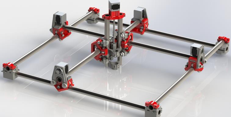

Also, what is the surface difference between seamless and welded pipe? I'm using the pipe to build machine like this:
There is going to be wheel bearing rolling on the pipe. Will the welded SS pipe has a rough weld seam or it will be smooth like a tube?
Fancy! The weld seam is in the inside. You can see where it is on the outside but it is smooth. The welded pipe is cheaper.
What do you want to make? Cnc Router?
