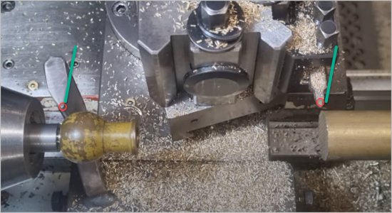

Need to figure out how to attach a Stylus like that so that it's on center.
I've always been pretty good at coordinating carriage and cross slide so it might even be easy for me. I think the hardest part is dealing with backlash. He appeared to be cutting while cranking the cross-slide both ways. I would have thought you only cut while pressing inward. But maybe that was just my impression.
Maybe because he already had the 3D doo-dad beforehand so it warranted mounting in the TS. But the stylus setup looks awkward to my eye. Now it also has to be vertically on center & the TS is no longer available for any longer part to copy. Maybe just a short part run trick for a few artistic shapes, which is totally fine. They look nice. Another approach is a 2D template located to the rear of the lathe & stylus mounted to cross slide. Industrial versions even had hydraulic feed.
It is important that the stylus & cutting tool match exactly for the entire range of cutting profile. Maybe my eyes are playing tricks but in the video it almost looks like his hockey stick stylus might give a false contact read if the angle shank contacts before the cutting tool tangent.

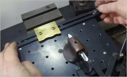

There was another gadget, I think Blondi was plugging it at some point. Kind of a hand held affair that slid on a platen on the cross slide? It appeared to work with very light cuts on brass but I value my 10 full length fingers LOL.
I think it was setup sold by Eccentric Engeneering call a turnado.
, pretty cool tool !
I had a friend who was so good at turning shapes freehand, he laugh at me when I told him I built radius turning tool. He said balls , sphere are the easiest to turn. contoured lathe handles just takes practice. Last time I tried a ball it turned out reasonable for a first and I didn't need to pull out the radius turning tool out.
Yup, that's the one. I don't recall seeing the (actual inventor) video but somehow doesn't look as scary anymore. Of note, here is his 2D copying attachment
