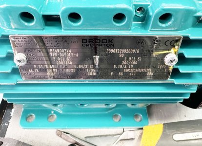

BTW, the motor is an "Inverter Duty", I believe high quality motor.
Looking at your motor plate, it's a very good motor.
You can run full torque at 12Hz
And 66% of full torque at 4hz
You lose the ability to achieve full torque even for short times at 3hz.
HOWEVER - These are extremes. I don't recommend running below the constant duty rating at 12hz so I'd suggest a minimum of 15. That's still an amazing range! I didn't see high speed ratings on the label but you might be able to get them from the motor manufacturer. Although I'd bet you are safe at 90hz, I'd still suggest 75 and maybe more for short times.
That gives you a function speed range of 5:1 without using any gears!
Remember that you lose HP as you go down the speed range from 60hz and lose Torque as you go up. Its not a good idea to push your machine too much. If you choose a gear that give you the machines max rpm at 75hz, you can probably use the machine while rarely changing gears. Except perhaps to add some grunt at low rpm.
Ya, nice motor!
