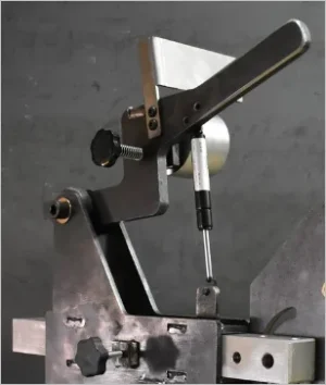

so many ways to skin the cat, but I guess a picture doesn't say how they operate without seeing feedback.

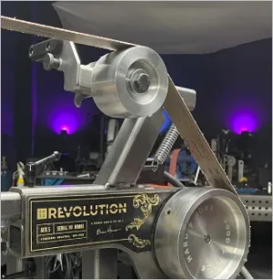

My eye wants to see torsional rigidity on this floating arm component
That's what I was thinking, 800$ for 100$ (if that) worth of plate, that's a pretty good markup, I'm in the wrong buisness
I get it. But there is a reason why people are still buying 2700US$ grinders.... it isn't because they are profligate with their money... There have been 4 or 5 startups to my knowledge that sold complete 'flat kits' - all the plates laser cut or waterjet cut to make one - in the 400$-600$ range. Most of them are gone. And many guys just don't have the skill or tme for a new project - they just need a grinder, "now"..
I think I'm going to build one from some 1/2" plate I have in the 'yard'... but I don't own plasma, waterjet or laser. So I'll have to forgo all those fancy designs and (sigh - or is it 'yay'?) design it to suit my materials.
I refuse to spend that 1000+$ for grinder bits when I have 2 6X48 grinders. So mine will have to be on the cheap-cheap to be attractive to build. I did buy the odd roller and keep an eye on other parts, with the intention that I might build one!
Often the least rigid part of the arm for torsion is how it is attached to the frame. A weakness in many designs, in order to keep it simple, or no-weld, etc...

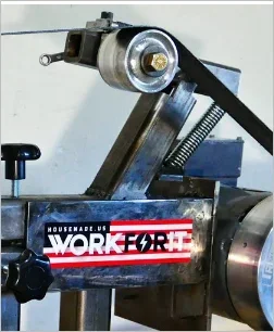

These are plates I use to make small etching presses. The hole alignment is perfect, the finish is good enough that I only need a light sanding in the take-up bearing slot in order to install the take-up bearings. Ream or tap, chamfer, sand, prime, paint and assemble. If you plan to assemble with a mig welder you can simply run a grinding wheel brush over the areas to weld and be ready to weld in seconds. Tenons drop right into mortise holes easy peasy
3 plates stacked together. holes align perfectly

Not intending to be critical of the design, more an observation. This vertical component holding the idler wheel looks like it could be prone to bending side to side & that could cause tracking issues. Other designs seem to have a very beefy arm or it's integrated directly into the frame & only the axle changes angle slightly if I understand the mechanism correctly. Maybe before you toss your design, consider an upgrade in this particular area like square tubing or something more rigid?
Unless you are saying its just time for something new. I spent some time a while back collecting ideas & prices & plans but its an official back-burner project. The kit & commercial prices are up there & if anything getting worse with FX & shipping. If you got hold of some plans you like, you could get the parts water/laser cut. Yes they charge money, but shipping steel across the country has a cost too. I think Clough42 mentioned his SendCutSend parts + motor/vfd + wheels etc. ended up costing 2K (I might be off, watch the video). But that's USD & not sure if that was his incentive price etc. But he wanted his machine with his design features so it was worth it to him. A lot of guys don't have welding facilities which many of the kits require even though they have nice interlock tabs to help with alignment. I haven't seen too many 'bolt-together' only designs but I'm sure it would be comparably rigid if designed properly. Good luck!
Yeah, I have been thinking about designing a tensioner that is pressed straight up from a square tube rather than a lever. The arm I have installed has a flat bar on both sides of the wheel and is connected to the outside of the center tube to keep it straight. However, the arm got twisted somehow, so I want to have a tube slide out another one with the Gas spring set underneath to press the belt straight up.
