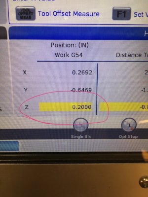

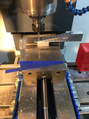

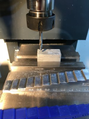

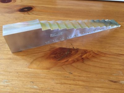

A frequent concern with CNC milling is making sure the top of the stock is known correctly and the tool in the spindle is set to the correct length. If either of these is wrong then you can ram the tool into the stock or table all too easily. I designed a height gauge to help confirm these details are correct. Below in the program line N55 moves the tool to 0.2" above the surface to be milled. Typically you step through the program to that line and then check the height. CAM programs typically generate this command before every new operation. Rulers are awkward to verify and just eyeballing it can be wrong. I don't know what other people do but I let the program slowly move the spindle to this height and then check it with the gauge. I started with a plastic one 3d printed which was very effective. Just recently I made one from aluminium. The step height on each step is actually a little under the nominal height so the gauge will just slide under the tool.

N55 G0 Z0.2 <- STOP THE PROGRAM HERE AND CHECK HEIGHT

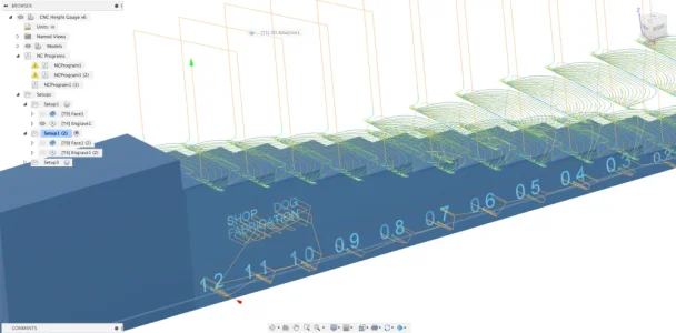

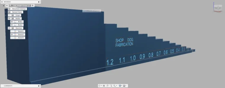

Screen Shot 2020-09-26 at 2.46.35 PM.webpScreen Shot 2020-09-26 at 2.47.58 PM.webp
Figure 2 showing the CAM milling operations.
Picture 1 shows the tool 0.2 above part supposedly. Picture 2 shows the machine thinks it’s at 0.2”. Picture three shows the gauge just under 0.2” so yes it is correct. Also the old plastic gauge in the foreground.

Great idea for a height gauge. Looks nicely done as well.
