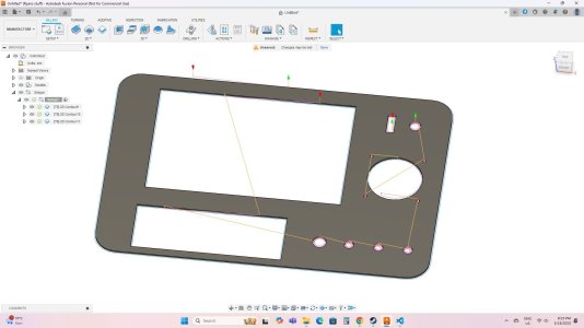

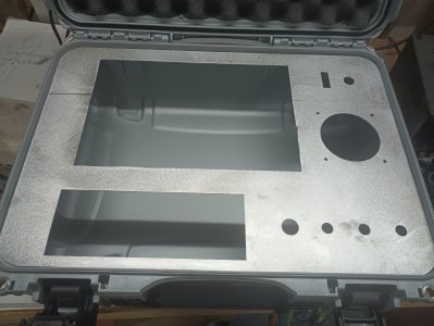

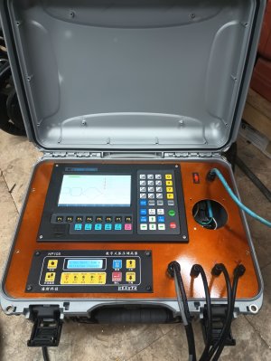

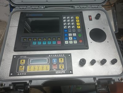

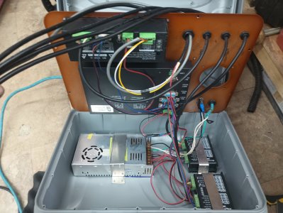

Hmm, i didnt update this, i ended up ditching mach3 shortly after this, and bought a fanuc plasma controller and thc module off ali, much more reliable, but expensive (relatively). I made a hideous enclosure for it, and thats how its been for to long. A new enclosure has been in the back of my mind for a long while.
Anyhow, an apprentice gave me a big enough water tight pelican type case he found in a dumpster, something ive been after to put the controllers into for a long while, the aluminum for the faceplate was a freebee from the neighbor and not really good for anything else, so this all worked out.
a nice sunday rain day project, after some other rainy day projects, tomorrow i may transfer the rest of the electronics and re-wire. So far pretty happy with how its turned out.
