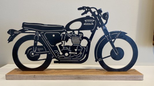

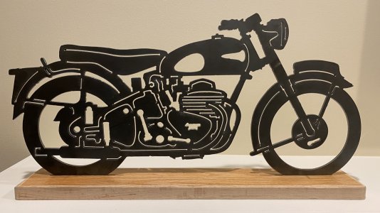

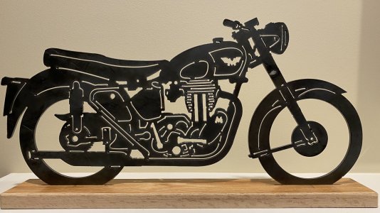

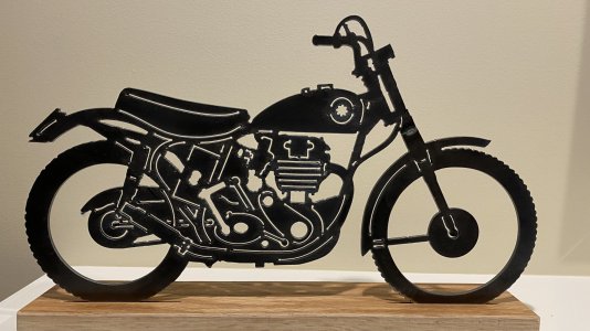

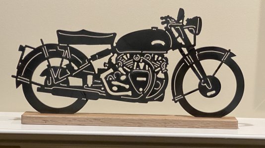

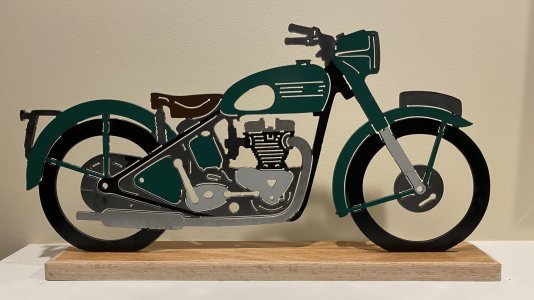

This may not be the place for it, but here are some 19 inch long shapes I just cut from 11 gauge steel using my small CNC plasma table.

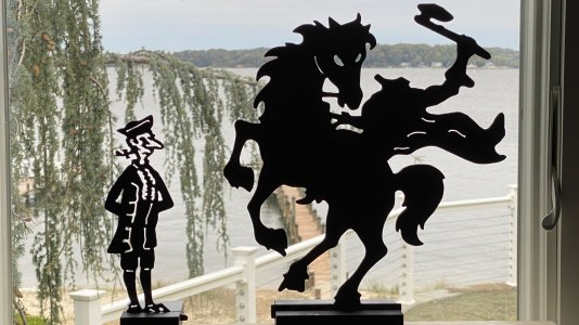

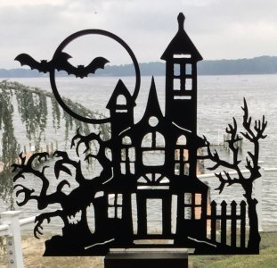

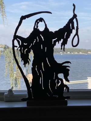

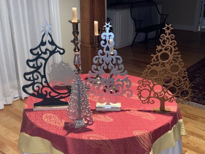

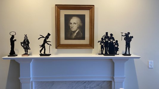

I have no interest in selling them. I just do it for fun. Here are some more shapes I cut out for the Holidays.

I do them all myself. Most of the on-line dxf files are either overly simplistic or unworkable using plasma arc. They either contain shapes within other shapes that will fall apart, or lines that are way too close together for plasma unless your figure is impossibly huge.

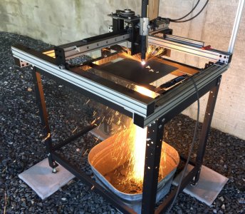

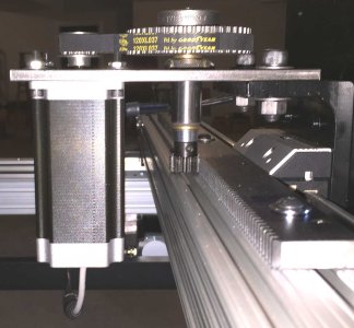

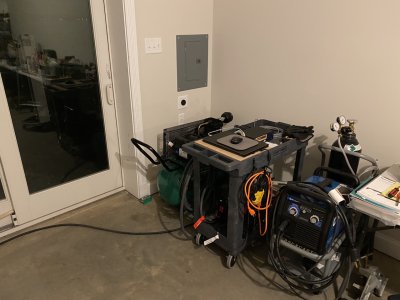

I built it myself. I used Flashcut driver software & electronics. Draw the shapes in CorelDraw.
Tell us more! That’s a fantastic build Tmate. Does it have a torch height sensor? What was your budget? More pictures!
Tmate
Well-Known Member

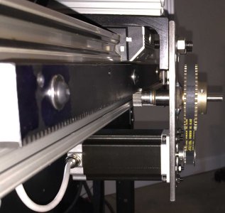

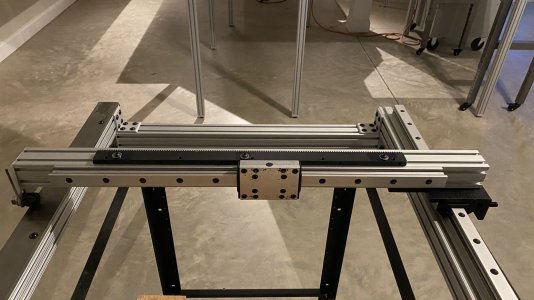

My table has a small capacity (about 18" square) so it doesn't need a height control. I buy 11 gauge steel in 15" or so squares, and in that small size it is flat. If I want to make something bigger, I do it in two pieces and tack weld them together. All the bikes were done this way. The table itself is a pretty simple build using a lot of off the shelf parts, and not particularly expensive. The Flashcut CNC electronics and software aren't cheap, but are virtually turn-key and vastly superior to that used on most of the bargain cutting tables out there.
I keep the machine under my back deck, with the compressor, plasma cutter, and computer just inside my basement door. Origa (Parker) linear rails and roller cassettes were used. Cheap ball bearing linear rails won't work here. The table is constructed of 8020 aluminum extrusions. See photos.

Nice machine. Where did you source the gears?
