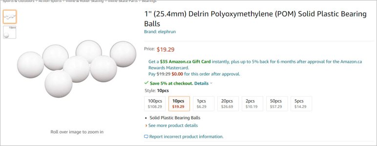

Thanks for the link. I do have lots of white delrin, but decided against using it on this lathe. I already broke tradition on the Colchester and made the replacement handles white - will change them to black in the future as I am forever trying to keep them clean and white…
Ya if McMaster doesn't stock non-white chances are its going to be more obscure.
https://www.mcmaster.com/plastic-bearing-balls/
I checked some of the offshore suppliers - 99% are white or off white, the odd clear. Nobody cares about bearing color so natural is the way they come. I think turning from solid like you did is the way to go. Only other way is make a mold & use pour-in color urethane. More of a pita unless it was a premium resto project.
