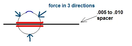

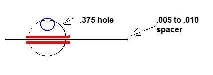

here's my take on this: Make the holes .375 BUT there's a trick to it (there's always a trick)
You mill the holes with a .005 to .010 spacer, then after the boring is complete, relieve the holes (shown in red) an additional .020 - this relief amounts to about 15% of the diameter (if you include both sides) when complete. Now there is no way for the jaws to 'pinch' the pin when released, and when you tighten you get positive, repeatable clamping.
I don't quite get it. Sounds like to me I should bore it 0.375 diameter (with the spacer )and then bore it again to 0.375+0.020 = 0.395. Why is that any different than just boring it to 0.395 in the first place? I think I'm missing something.
it is just to relieve the centre of one jaw, not the complete hole. this form 3 points of contact like this: I'm sorry for not being clear, or illustrating poorly...
