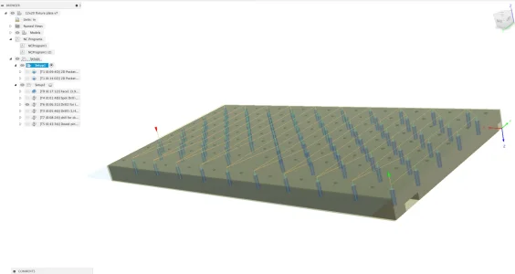

You know how it seems you need to make tools so you can make tools for other tools? :D Well I'm working on a clamp project and to mill out the clamp arms I need a big fixture plate. Here are the 6" arms laid out for milling. That's 8" by 15"
This the mill cutting model.
So for that I need a way to hold it down to the table and I'm making a 12x20" aluminium fixture plate with about 50 1/4-20 holes and 50 1/4 dowel pin holes.
Some progress pics of the fixture plate. Now I need to get out to the shop and do the dowel pin drilling and reaming.

John, I'm not quite getting the utility of the jig plate in this particular application. Is there a spoiler board under the stock or you are OK to re-surface the jig plate after (I assume) the mill has penetrated through the stock into the jig plate?

Pete yes I will just face the fixture plate after making the part. No spoiler board.

There is no issue skimming your tooling plate after the job is done but seems a shame to loose expensive material every job. You will also likely be cutting across threaded holes with the curved parts. But maybe I just use my jig plate in a different way & this is common practice in cnc? (I'm kind of illiterate in this regard).

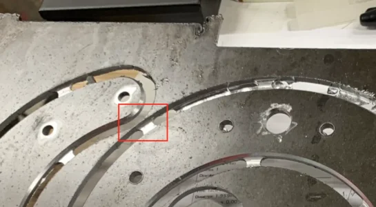

Clamp arms milled. After breaking an End mill Alex checked my program settings. I did it at 60% speed about 6000 rpm and 12ipm instead of 25. Step downs of 0.04” so about 4 passes. Material is 0.144 thick. Flood Coolant. You can see the tabs holding the arms to the plate. Need to band saw the tabs off now and sand the edges.

Why can't your mill paths overlap to get less waste? It seems like you are deliberately avoiding cutting where you have already cut. Just eyeballing it, it looks like you could save 20% or so by overlapping the paths.

Here you can see where the tab attaches to the stock. I kept the pieces well apart so the tabs always attach to the stock AND I don't make any islands of unattached material. The EM is pulling up like crazy on the material so anything that is not well supported could come off and do all kinds of damage. This is also the first time I've done milling with tabs so I wanted to be pretty conservative. No problems (well after I busted a EM there were no serious future problems). The design of the clamp arms means there is a lot of waste. A better more nestable design for the arms would help. Maybe V2.

Also nesting on a waterjet or plasma table is simpler as you don't have to worry so much about parts going flying. You could bump them really close together then.

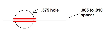

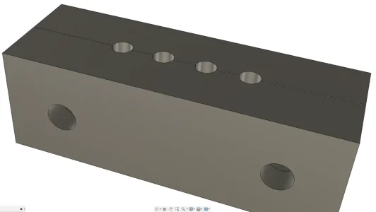

Ok now I have a question. I need to make this soft jaw to hold some 0.375 rod to make the clamp standoffs. what size should the holes ideally be? 0.376? 0.377? 0.385? I've done this before making the holes the exact size as the stock. That worked but I had to knock the parts out with a hammer after loosening the jaws. Thoughts?

You could always mill the holes in your clamps first and use them to hold the clamps down to your wasteboard. that would allow you to remove the tabs. you just have to make sure the screws are tight or the clamp body's could shift during cut operations
EXACTLY what I was going to suggest. Glad I read further down before diving in. In addition to that, I'd suggest that more holes wouldn't hurt the function but might improve hold down.
I can point you to some tolerance fit sources, but the very first question will be what is the size & variation of the rod diameters? If its like O1 drill rod, might be 0.375 +/- 0.0005". And my experience with that stock is the section can be slightly eliptical which isn't quite the same circular section with +/- tolerance. If you are using more conventional stock, all bets off. Ground shafting is better but i suspect you might not be milling that?
I haven't done enough jig work like this to know for sure, but I suspect why they work (or don't) is aluminum is more ductile & distorts a bit during clamping. Say the 2 left shafts are plus 0.001" & the right one is minus 0.001". Now the jaws are bridged open on the big ones, no way the right part can be gripped as tight. To the extent it may not be tight at all or worse, come loose during machining. If gronk solves the problem (jaw distortion) that may be acceptable for the batch run, but just this issue could be a possibility. I've set up so called identical parts in my mill vise for same operation face milling & had a few surprises. What usually solved the issue was paper or something to take up the varying gap. Your self centering application would probably not lend itself to this unless the jig was a series of Vees.
here's my take on this: Make the holes .375 BUT there's a trick to it (there's always a trick)
You mill the holes with a .005 to .010 spacer, then after the boring is complete, relieve the holes (shown in red) an additional .020 - this relief amounts to about 15% of the diameter (if you include both sides) when complete. Now there is no way for the jaws to 'pinch' the pin when released, and when you tighten you get positive, repeatable clamping.
X2 was Dabbler said. Works very well, especially with aluminum soft jaws.
If you want to go really fancy, you can make your jig holes with just 3 points of contact. Steve Barton over at Solid Rock Machine Shop shows that in one of the videos (sorry, can’t find which one at the moment).
