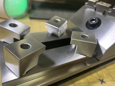

There are advantages of case hardening like a dead hard skin (no need to temper), ductile core and user much cheaper hunks of mild steel. You call also make it do tricks....for example suppose a tool makers block with threaded holes. You don't want to harden threads. No problem with case hardening. Send it out for long soak to get up to 50 thou case. Don't quench and do a slow cool. It'll be annealed. Now drill and tap all the holes in the annealed material then send it out the quench. Of course only the high carbon skill will hardened, not the threads.
Here's one of a pair of 3x4x4 blocks I did eons ago using the above technique. I couldn't of afford tool steel of that size but CR wasn't too bad, and dead hard is harder than tempered. I put a lot into grinding those, they're with a tenth over six inches square between all planes. I'm using it here to check a square
