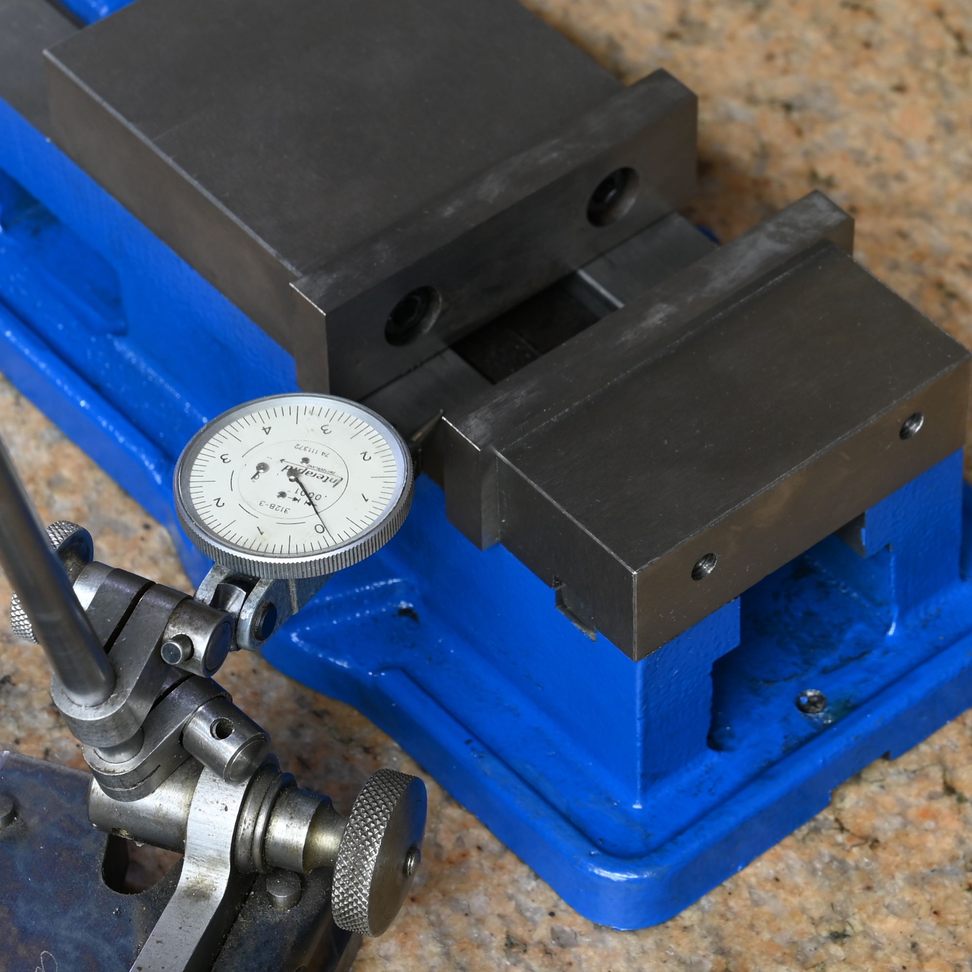

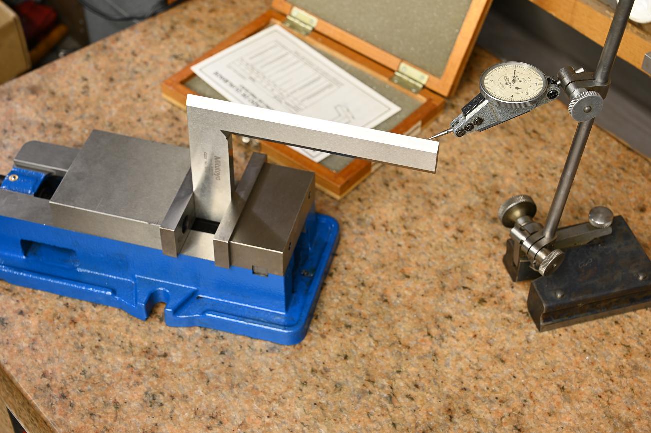

I said I'd do a quick survey of the happy vise, here are the results. Whats acceptable to someone is variable thing but for me and imo its a poor show putting out tooling like this. What should be universal though is disdain for false claims. I've had roles in two business that exposed me to manufacturing in the China and 10 years ago vendors filling in a certificates was simply a marketing exercise....the certificates function is to tell the customer what they want to hear and if they don't notice, win! I was hoping things had changed as they start to discover branding. Anyway, I really dislike that style of commerce.

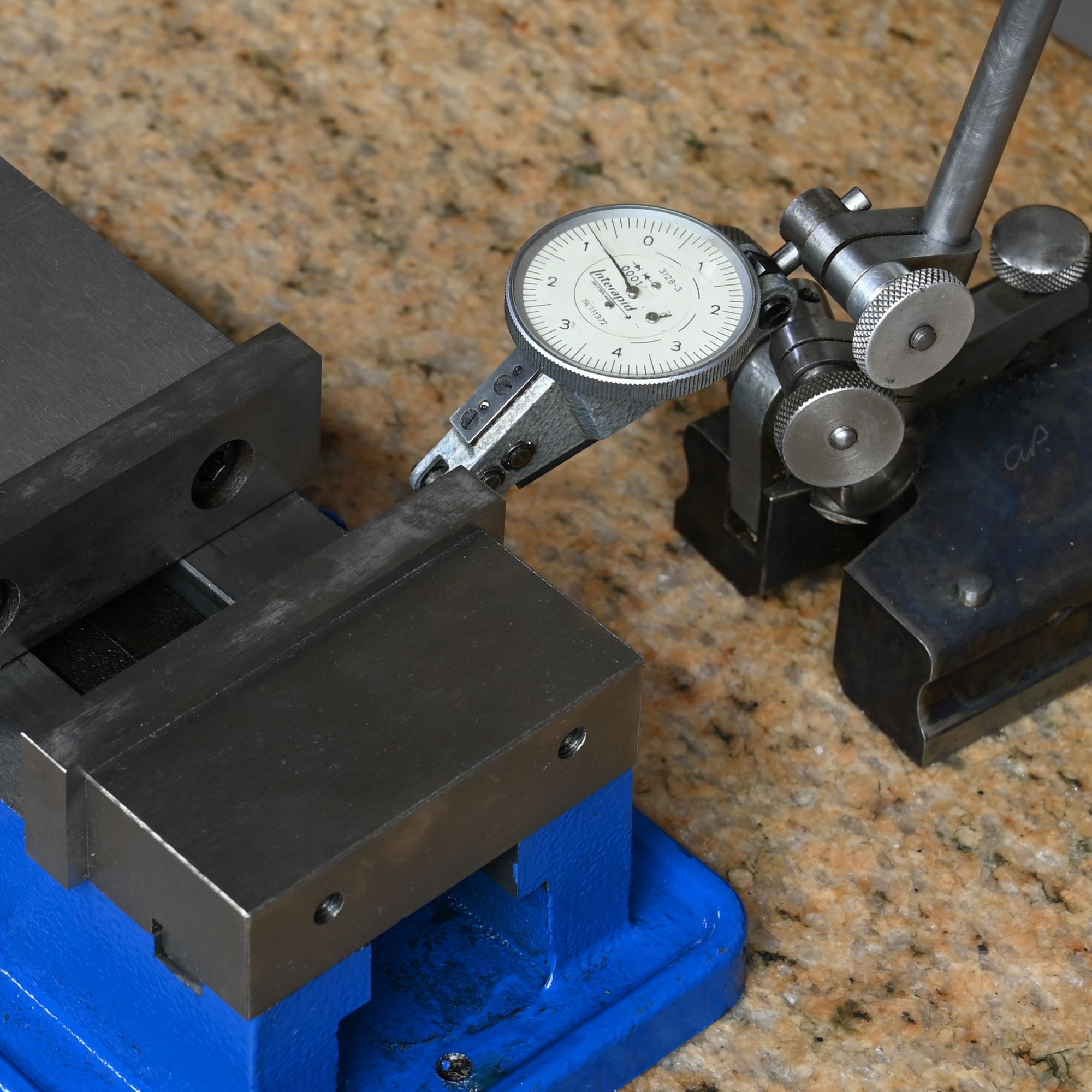

Test were done a pristine Starrett grade A inspection plate using a interapid 10ths indicator. The parallels are proven and everything was repeated several times to check for dead on repeatability
Indicating the four corners of vise ways shows that they are close to within tolerance

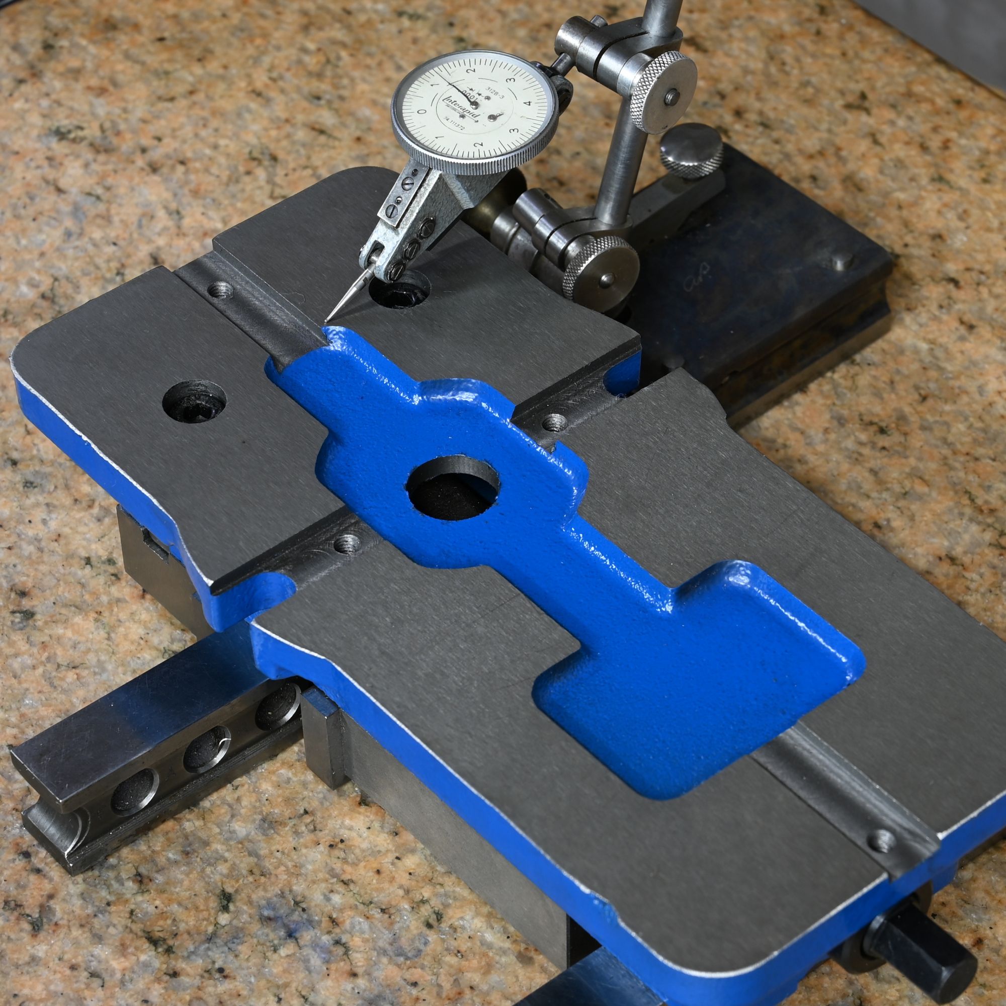

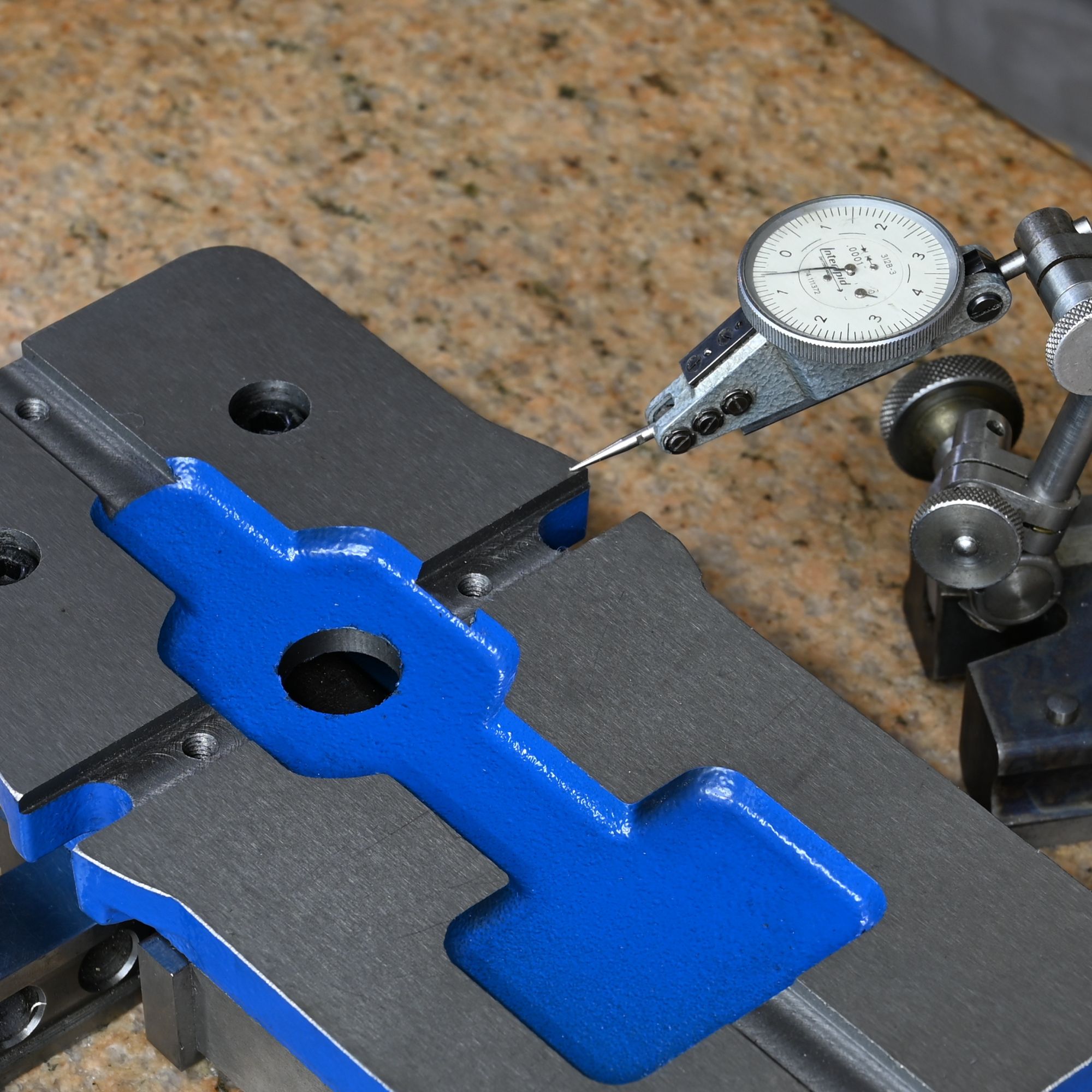

However on flipping the vise over and checking for parallelism, there is lots of variance across the surface. As much 002" over a few inches. That seems like a huge amount for a ground surface and as soon as you bolt it to something, the base will distort and would put the ways out of tolerance (the already are but just a wee bit)
you can see across this short area there is a 2 thou variation. At first I thought the fixed jaw must be warped and is pulling the base out of shape, but then the first test would have mirrored this, but those top surfaces were close to ok.

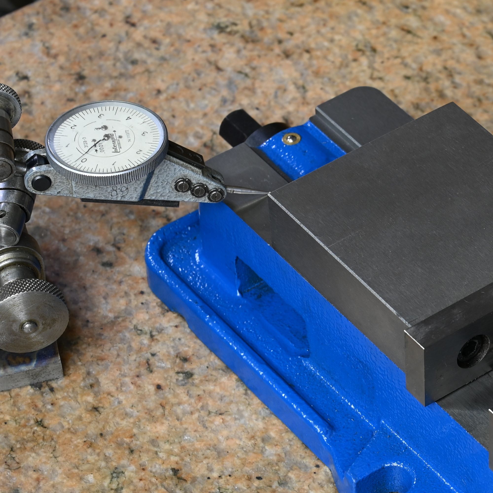

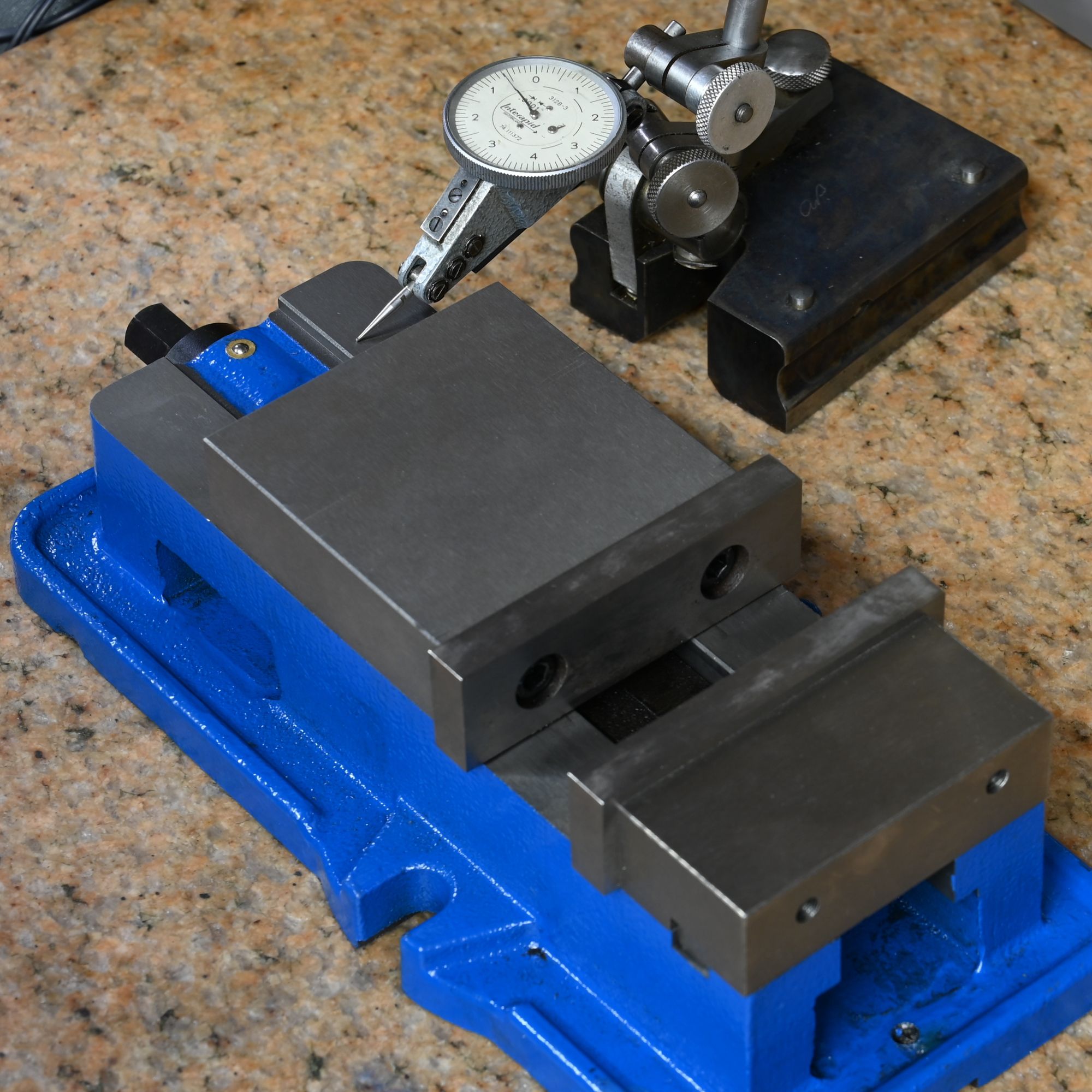

Where there is no doubt as to false claims is squareness. They claim its certified to .05mm per 100mm. I measure 8.5 thou over 6" which equates to .096mm over 100m! That square is mitutoyo certified grade 00, bought new by yours truly and only used very rarely and only for inspections. certified to 5 microns or 150mm. That is very loose standard by tooling standards, and this one is almost twice that
Everyone has to decide for themselves what they want and whats acceptable, but go in eyes wide open. If there was ever any doubt about the credibility of certificates and claims of these manufacturers, hopefully this shows what we're up against

One thing I was wondering on the jaw test. Could you grip your square with something like soft copper wire on one jaw so the square is seeing effect of only one jaw at a time (where fully mated) - take a reading off your square, then flip to wire to other jaw. Maybe hey are both canted or maybe you are seeing a combined effect?
Do you have grinding/scraping provisions to get that vise up to snuff? Maybe not as simple as it sounds but treating these like a semi finished kit might be worth it.
Hi Peter,
I didn't do the test you describe, To my knowledge when grinding a vise, you square the fixed jaw and not worry about the floating jaw.
A bit of something between the moving jaw isn't a bad idea; it would remove any doubt as to the source of error to the fixed jaw. However, just like when milling, you'd expecting the work to be located by the fixed jaw not the moving one which has enough play to conform. The test as done show the vises current condition, it replicates holding a work piece.
when it comes to grinding each part a lot more effort will be made to quantify exactly what is out where, part by part. I would probably start by scraping the bottom of the base and then grind as I move upward....that way you get a flat and reliable datum surface to put on mag chuck (if not, the mag chuck will distort the work)
I do lots of scraping and have a surface grinder that sees a lot of use and I've ground vises before so getting it in shape isn't a problem. With the bolt on fixed jaw they're an easy style to grind, provided you're taking off so much you mess up the screw alignment. I'll probably do that to this vise just for kicks (like I need another project). My reluctance is that it's too tall to be ideal for my purposes; I wish the designer scaled down the base along in the same proportions....so I keep thinking of making one...but it would a D2" (2" copy of a kurt).

The underside of my vise shows the same 2 or 4 thou dips here and there.
