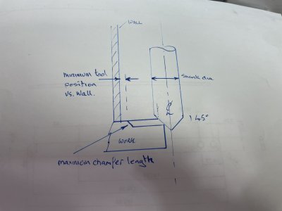

Yes, but... there is a tool standoff as well - i.e. the shank must stay clear of the end of the edge because it would run into a wall. The chamfer toolpath will have a setting for that, the value is usually 1/2 the tool diameter, but if you are using the upper part of the flutes, the shank clearance can be very small.

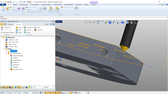

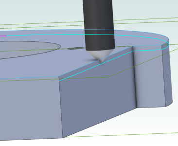

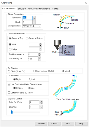

Got it! Here's the simulation.
With these parameters

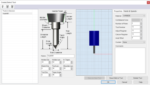

And I can define the tool here as a V Mill. The software is smart enough to know if the tool holder will run into a wall based on tool length and holder size. I set the max dimensions of the TT collet holder.
What CAM is that John?
Well it was AlibreCAM (still is although it crashes regularly with an invalid pointer error) but it's actually MECSOFT VISUALCAM which is part of their advanced VISUALCAD/CAM software offering.
The demo software lets you do the same thing with the .STEP file that it can import but of course I can't save it.
