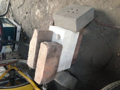

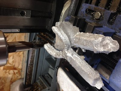

The fire bricks I picked up earlier this year have worked out great as a quick to make mould, it's a pain to carve accurately by hand but has been working great after 10 castings, I had nothing to burn out (foam/wax/pla) but without a vent a bubble can still form and ruin the cast. At work when making rubber moulds for O&G the vent hole was small but crucial as they use an injection moulding process and air needs to escape the mould quickly. here is how I've been pouring and the result. Note the "biscuit" in the lower one, the result of an under cut in the fork breaking out after the first cast IMG_0080.JPGIMG_0073.JPG
