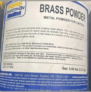

Anybody ever play with this stuff?
Yes, quite some time ago. Was part of a sample pack of different metal powders. Its very finely granulated, they list the mesh size somewhere. The composition doesn't necessarily correspond to a recognizable bar stock allow but bronze is some flavor of bronze, brass is some flavor of brass etc. You probably know but its an additive to a casting resin. Aluminum (alumina?) is an additive to epoxy for specialty tooling for molds to give it toughness, stability & temperature capability.
