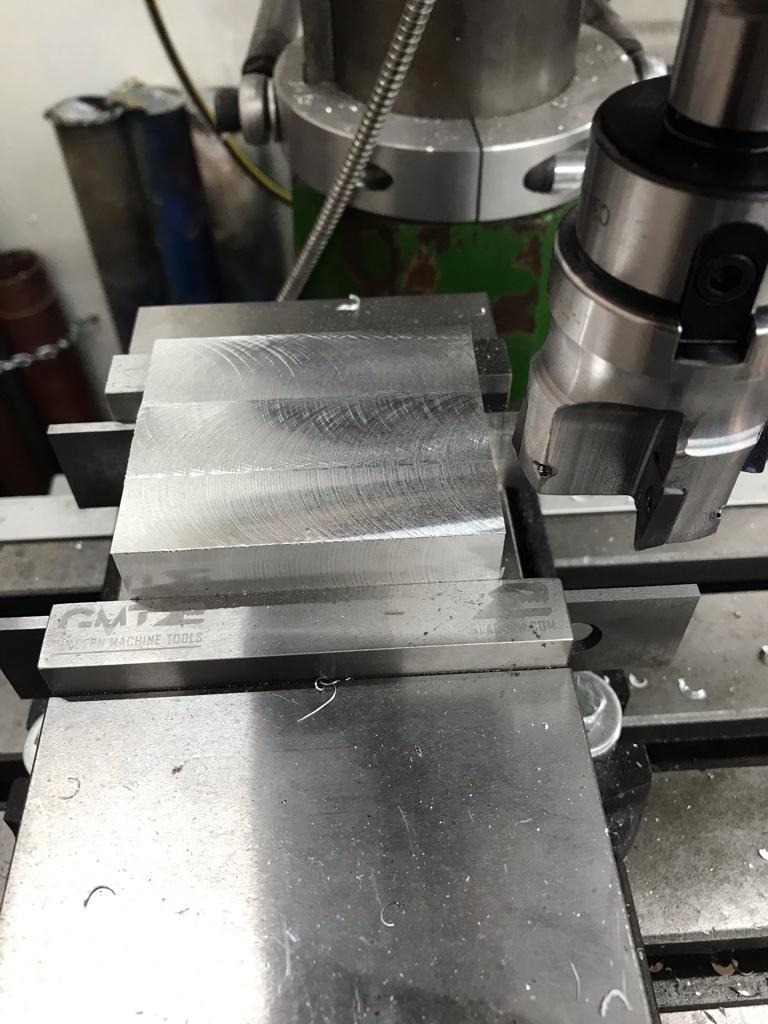

I ended up buying one of the 2" four-insert face mills on a whim.
Got it with a 3/4" straight shank so I can just put it into my MT3 collet.
As i posted earlier, I have one of those. I just finished a rotary table back plate and did a trial, one pass with that (on 4140 steel) and another w/fly-cutter.
Results: fly cutter every day of the week, twice on sunday! I used fresh inserts too, but the heat generated by the tool + finish quality was brutal. The fly cutter made it look easy.
But, when used on other material, I like it.
So the face mill arrived today.
Quite decent looking.
Works well in aluminum as would be expected.
Steel is also darn good.
