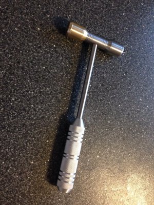

Title really says it all. I'm working on making a soft hammer, how does brass compare to lead?
Thanks @Alexander for the brass cutoffs, and @Kris Jensen for the idea.
Toxicity of lead a consideration?
Any other materials for consideration?
This is more project for practice on the lathe than anything, but figure I should do it as best I can.

Both have their place. Brass is much harder than lead so it doesn't wear down like a lead hammer. Lead doesn't bounce so it works as a dead blow hammer. Lead is also inexpensive and easy to cast into any size you want.
Personally I use a cheap plastic headed hammer.
I made some hammers a while back. I have attached a picture. I think for automotive work like fixing your car the brass hammer works best. If you need to smash on something with all your might it is the right hammer for the job. For machining the lead hammer is nicer. It is softer and heavier.376551_10150447853797148_1499193494_n.jpg
I went with removable heads,
The brass section and the opposite part come off. I'm going to gather some lead to cast a replacement for the steel head.

Nice knurling! What kind of knurling tool was used?

@Jwest7788 that hammer looks gorgeous! Do the faces have a female-thread in them? How is the handle attached to the head? Great job!

Thanks! Yep, female threaded heads on this hammer. 🙂
