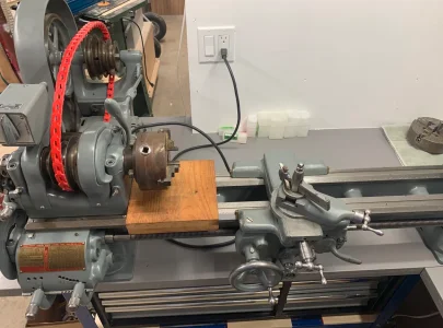

It is a SB Model A from mid 1960s. It has the under drive. The carriage is a kit from Metal Lathe Accessories. Not sure about the link belts, they work very well, but I haven't tried using them in reverse.
Looks like a great lathe, check it over, give it a basic levelling, see how it cuts, tune it from there. Don't worry about not having "everything", see what you can do with what you have. "Money" takes care of the rest, learning how to make tools and making tools to learn can save some. Learning is like money. Get your hands on one of the South Bend books, some of the older ones seem to be better.
The lantern style tool post is not the worst, sometimes it will work where others won't, don't bin it. If it has the threaded on chuck, (I think it does), remember it can come loose/off cutting backwards. There have been various locking devises used/devised.
Try to get all the sawdust out/off it, some types are very corrosive with the slightest bit of moisture. Check gears for play and lube. Make sure the carrage clutch does not not stick/bind when used, in hand with that don't over tighten drive belts, slipping belts can help prevent a "bad" wreck.
Others will have more.
Have fun, look foreward to seeing some projects.

Ok, now with new pictures showing it installed alongside it's baby mill brother.
And, yes, I realize I put the Kreg table stretcher upside down. Not going to change it now!
For those with stiffness concerns, the tables are 1-1/2 thick glued up cabinet grade plywood and are screwed along the rear edges to either concrete or stud walls, and the stud wall is clad in 1/2 plywood, not drywall, for added stiffness.
Since the unit I bought was actually a freestanding model, I carried the mounting plates across to this setup, but left the legs and pan behind. The seller was wanting to use them for his wood lathe project and I've since bought some oversize baking pans to catch chips and drips. No plan for lubrication system (for now).
Despite it being in really good shape, I did discover the previous owner had packed the lead screw and worm with ordinary grease rather than the designated oil. Took quite a bit of time to clean that out without tearing down the entire unit. Will be returning to oil for lubrication, as per SB documentation.
Change gear cover is removed as the pin which carries it has worn loose in the casting (sags and drags on the spindle) and I will need to repair that, so it will run unguarded for a while.
